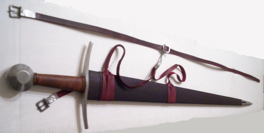

I have just completed a new Poitiers scabbard for forum member Andrew Babbini. Andrew wanted a fairly simple scabbard, so i tried to follow that in the simple decoration of the mounts and chape.
The body of the scabbard is a poplar core covered in chocolate brown leather. The suspension is oxblood leather with hand forged buckles/belt-mounts. Comments and suggestions are welcome.
Dan
P.S. Sorry for the poor quality pics, photography is apparently not one of my talents.
 Attachment: 20.37 KB
 Attachment: 30.05 KB
 Attachment: 42.65 KB

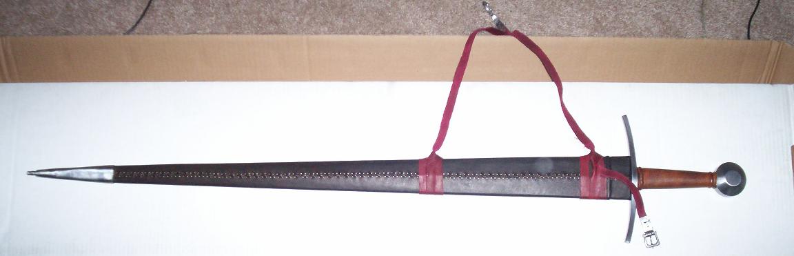

A shot of the back.
 Attachment: 46.68 KB

Looks good. How did you make the chape?
Profile PM
Dan Dickinson
Location: Michigan
Joined: 03 Oct 2004
Posts: 967
PostPosted: Fri 11 Jan, 2008 7:21 pm    Post subject:         Quote
I made it out of sheet metal with the seam up the back and the finial on the end welded on. I then removed the material from the cut-out decoration.

I'd like to see a close up of the chape construction. It looks very good. Is it a one piece with welded seam up the back, or is only the finial welded on? Also, how did you make the finial?
Profile PM
Dan Dickinson
Location: Michigan
Joined: 03 Oct 2004
Posts: 967
PostPosted: Sat 12 Jan, 2008 8:36 am    Post subject:         Quote
I formed the chape out of sheet into a flattened cone with the ends meeting at the back, then inserted the finial into the small end. I then welded the seam at the back and around the end. The finial is a piece of steel rod that has been decoratively turned.
Hope this explanation helps,
Dan

PostPosted: Sat 12 Jan, 2008 9:06 am    Post subject:         Quote
Looks great! How did You fix the chape?

I apologize if this is getting little old. I have made one scabbard in my life. The carving went well but inefficiently and I used too hard a wood. however I had to recycle a chape from a windlass scabbard as I had no idea mow to form one from commonly available hardware supplies. This is the main piece of information I look for in every scabbard thread. I read people talking of forming them on mandrel but what do you use for a mandrel? I also hear of using bee's wax when fitting leather wraps to both grips and scabbards but don't understand why or how? I don't want to badger you about the chape but the forming process has me stymied. Do you do your own welding and with what?
Profile PM
PostPosted: Sat 12 Jan, 2008 11:05 am    Post subject:         Quote
Some scabbard makers have built there own mandrels, I believe. Some have pieces of wood/metal with channels in them that they use to get the U-shape, then they bend it around the scabbard tip.
Others, depending on thickness of the wood and workability of the metal chape material, use the scabbarded sword as a mandrel. What better mandrel than the actual item the chape is ending up on? :)
Profile PM E-mail Website

Dan Dickinson
Location: Michigan
Joined: 03 Oct 2004
Posts: 967
PostPosted: Sat 12 Jan, 2008 4:13 pm    Post subject:         Quote
Ok, let's see if i can keep the questions straight. First, the chape is fitted to the scabbard using a friction fit...i.e. shaped to fit quite closely placed as far as hand pressure will allow and then tapped into place the rest of the way with a rubber mallet.
Secondly, I didn't use a mandil for most of the shaping, but instead slowly bent it a little at a time, using a vice and rubber mallet and finishing with an armourer's stake towards the end. I'm afraid I don't do my own welding yet, but had a friend who own a body shop weld it with a MIG welder. After it was welded together I used the scabbard as a reference as I adjusted the fit. As far as beeswax.....I'm assuming that the reference you're referring to is using it as a sealant/reconditioner once the leather is in place.....not as a glue. For glue I used a commercially available leather cement.
Finally, as to why there is no locket at the mouth end of the scabbard:
Althoughs cabbards that often accompany many lower-end swords have lockets at the mouth, very few medieval scabbards (at least that i am aware of) had metal bands around the mouth just to have them there. Rather, most metal mounts found on the upper portions of scabbards seem to have served as attachment points for suspension rings .....since this scabbard uses knotted leather straps to attach it to the belt, metal mounts did not seem to fit/seem authentic.
I hope this helps,
Dan
