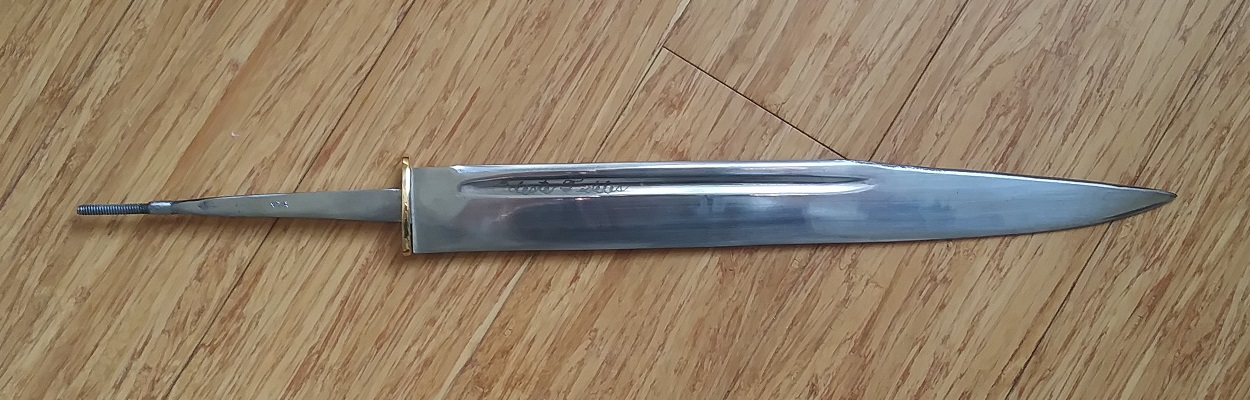

I've recently wanted to add a sax to my collection, but also need to rein in my spending. It occurred to me that my old Crazy Crow kit-built dirk (which I've wanted to be rid of for a while) has a blade profile much like a broadsax. Do you see any potential here? Or is it just going to look like a chunky dirk blade with a sax hilt? I'm particularly unsure about the beveled false edge.
 Attachment: 435.11 KB
Lin Robinson
Location: NC
Joined: 15 Jun 2006
Posts: 1,241
PostPosted: Fri 06 Mar, 2020 1:24 pm    Post subject:         Reply with quote
I don't. I used one of the same blades, along with some brass mounts, a pommel cap and guard, to make a dirk well over 30 years ago. I also have a couple more laying in a drawer in my shop. Mine are cast and I assume yours is also. For the time and effort trying to re-configure the blade, you could probably grind one out of a piece of leaf spring that you would like better. And there is no telling what you would find once you started grinding on the casting.

Dan D'Silva
Joined: 28 Apr 2007
Posts: 287
PostPosted: Sat 07 Mar, 2020 2:28 am    Post subject:         Reply with quote
Huh... honestly, if it's such a junk blade, I'd rather just shelve the idea until my budget looks good enough to buy a decent one.
Well, it was worth asking Happy Thanks for the advice.
Lin Robinson
Location: NC
Joined: 15 Jun 2006
Posts: 1,241
PostPosted: Sat 07 Mar, 2020 7:50 am    Post subject:         Reply with quote
Mine, as best I can recall, cost less than $20 - quite some time ago. It was not marked but the two I bought later were marked "India." May be perfectly OK I just would find it hard to justify the work for what it might turn out to be in the long run.

Dan D'Silva
Joined: 28 Apr 2007
Posts: 287
PostPosted: Sat 07 Mar, 2020 11:03 am    Post subject:         Reply with quote
Here's a thought: How about I start by turning the false edge into an un-swedged broken back? That wouldn't take too much work, and it would hopefully reveal something about the steel quality. If it turns out to be poor, no big loss -- it's not doing me any good as is.

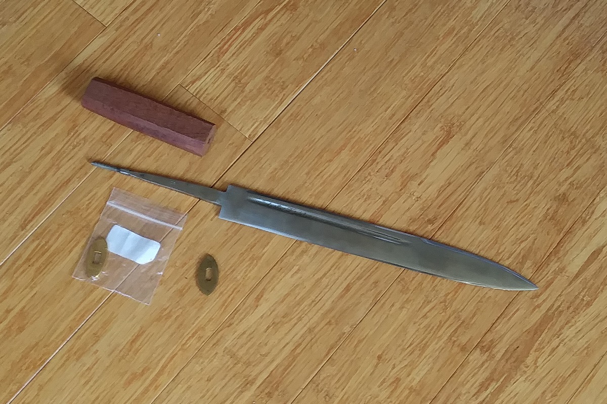

PostPosted: Fri 13 Mar, 2020 2:55 pm    Post subject:         Reply with quote
Huzzah, I have broken its back. Not bad for less than an hour's work, although it still needs a lot of cleanup.
Still not sure about the steel quality. It seems... harder than mild steel, softer than a Windlass. No pitting of the kind that I'd normally associate with castings, but my experience with casting flaws only relates to bronze.
 Attachment: 219.11 KB

PostPosted: Thu 23 Apr, 2020 11:18 am    Post subject:         Reply with quote
Just wanted to let you know, I haven't abandoned this project. It's just that filing out the handles for hidden tangs is easily my least-favorite part of cutlery, so I'm only spending about 10 minutes or so a day on it. But making noticeable progress nonetheless. Also evened out the broken back and re-polished the whole thing to a satin finish.
In the meanwhile, does anyone know where to get an appropriate pommel?
 Attachment: 175.53 KB

Kai Lawson
Joined: 26 Aug 2010
Posts: 589
PostPosted: Sun 26 Apr, 2020 7:29 am    Post subject:         Reply with quote
Pommel plates would likely have been a flat piece of iron, much like the bolster. You could use brass for color continuity in your case. Most sax/saex of the broken back variety would have had a grip of 30-45% of the blade length, generally. There is also little to no evidence of metallic fittings for broken backs, and only a few earlier specific Continental or Scandinavian examples show metal fittings--not counting fittings from the Staffordshire Hoard, which has nothing else. Looking up 'sax' or 'saex' on myArmoury or bladesmithsforum.com will give you loads of info and drawings and photos of the real deals.
However--you could try to tweak it to look like one of the Valsgärde saxes. If you google that term, you'll see lots of interesting examples of a long, bent-back blade with a shorter grip and sometimes metal fittings. The scabbards are also pretty fancy, and might be fun to try as well. I've seen one or two of them in person, and they're slim and dangerous looking.
An even better option might be to make a 'fantasy' piece inspired by historical examples. Make it totally your own, and do whatever you like! Just enjoy the piece, and be proud that you breathed new life into it. Burning the tang in might be faster too, if you have a good clamp or a vice and a torch.
Be sure to post your finished piece! It's looking good so far.

Dan D'Silva
Joined: 28 Apr 2007
Posts: 287
PostPosted: Sun 26 Apr, 2020 8:58 am    Post subject:         Reply with quote
Joel Chesser wrote:
I really like it, well done! It's a very cool trash to treasure project.. Happy
Thank you!
Hm... according to my measurements, the tang is a hair under 30 percent of the total length and 42 percent as long as the blade. Rounding out the blade and tang junction would make it longer.
It's interesting, and a little strange, about the lack of metal fittings, but looking at photos of originals, you seem to be quite right. I'm not dead-set on giving it a metal guard and pommel -- the guard in the photos was just lying around. However, I do think it needs at least a washer to secure the tang. The blade's just too big and point-heavy for me to believe glue alone will hold it, even if washers are rare or non-existent with broken backs.
Thanks for those pointers, and the encouragement.
I've thought about just that. It's already a bit of a fantasy piece in conception -- the reason I wanted one is because I was re-reading The Lord of the Rings last year. The mahogany grip is pretty unlikely, for starters, and since yesterday I've been going back and forth about whether to start over with an ash one.

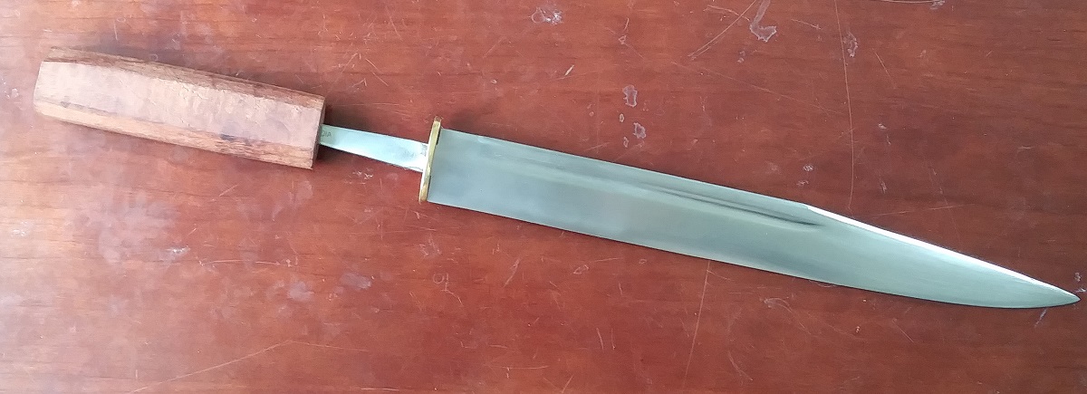

PostPosted: Sat 11 Sep, 2021 10:45 am    Post subject:         Reply with quote
Haven't forgotten about this one, but I've accumulated more ongoing projects than I can even keep track of, and between summer classes and looking after my folks, it's not easy to get much of any one thing done.
Anyway, it's still going according to plan and I got a bit more work done over the past two days, so I thought I'd share it.
 Attachment: 394.16 KB

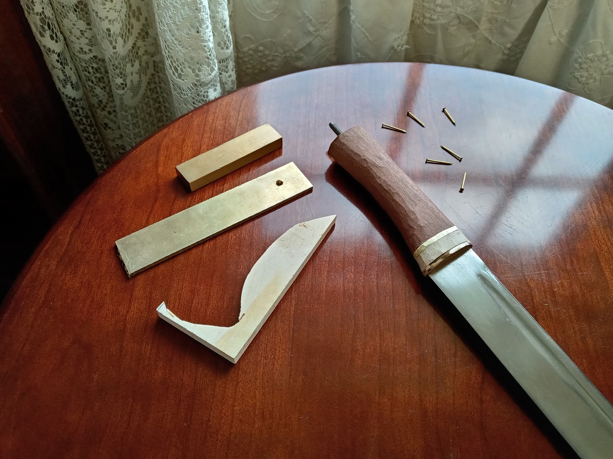

PostPosted: Wed 22 Sep, 2021 11:32 am    Post subject:         Reply with quote
Rough shaped the pommel plates and cap today, so it's coming to the point where you can see clearly what it's going to look like. Right now I'm trying to figure out how to fix all the pommel elements together relative to each other and the hilt, since the tang is completely round at that point. The best idea I have is a little hole on either side of the cap for a pair of long escutcheon pins, but the bar stock that I'm making the plates from seems pretty hard and might give such a measly little drill bit a lot of trouble.
The Crazy Crow bar stock that I used for the pommel cap, on the other hand, must be low-alloy or leaded or something, because it's very soft. It grinds into dust as fine as flour and when drilling it just produces tiny flakes instead of coils. It's also got a bit of a golden hue that unfortunately doesn't match the rest of the brass.
Anyway, in the meanwhile I'm just trawling the Web for more inspiration about what kind of detailing to fancy it up. On the whole, I'm liking this blade much better as a sax than as a dirk.
 Attachment: 249.66 KB
Alex Indman
Location: NYC
Joined: 13 Sep 2012
Posts: 152
PostPosted: Wed 22 Sep, 2021 2:37 pm    Post subject:         Reply with quote
I like how it is shaping up! Not sure "sax" comes to mind when I look at it, but whatever you call it, it will be a nice big fighting knife.
About assembling handle parts on a round tang - you will be usiing epoxy, right? If you just drill/grind a bunch of shallow dimples or cross-hatch the surfaces, epoxy should hold them from turning relative to each other.
Alex.
Dan D'Silva
Joined: 28 Apr 2007
Posts: 287
PostPosted: Thu 23 Sep, 2021 4:09 am    Post subject:         Reply with quote
Thanks. I guess it may not look like any sax in particular, since it's basically a composite of features from different pieces I've seen around the Web.
Planning to use pitch glue to reinforce the construction. I'll definitely try your suggestion for the final assembly. However, I want to start with a fix that will let the pommel be taken apart again after all the pieces are ground to the same diameter/cross section on the belt sander, so I can then give them their final sanding/polish without embedding metal dust in the holly. Right now I'm thinking of placing the escutcheon pins through the pommel plates in a position that will then be covered by the cap once it's soldered into place.
Would've been so much simpler to start with a square tang, but hey, working with what there is here.

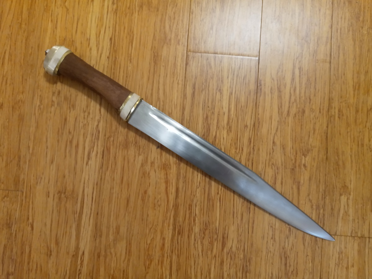

PostPosted: Tue 04 Jan, 2022 8:54 am    Post subject:         Reply with quote
It's done!
Dunno if it's clear in the photograph, but I etched a bird of prey on the pommel cap. The sheath is stained with a single application of homemade walnut dye, which is great because it contains sediment that naturally produces a similar effect to those leather antique gels.
Full details here as usual:
https://danthedsilva.blogspot.com/2022/01/fancy-fancy-knife.html
