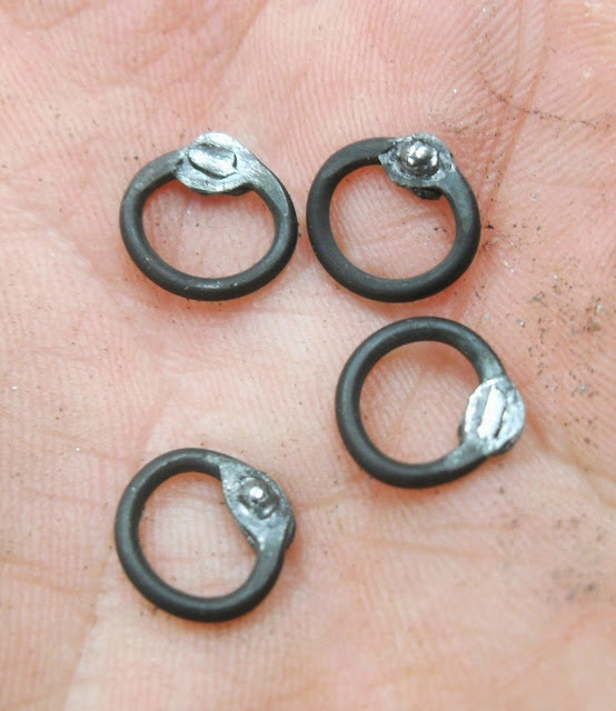

Kai,
I have a bit of the watershed thing going in these rings, but it's hard to see for all the random tool marks. The setting tool I used was a hand-held punch because that was easier to experiment with than modifying a pliers.
I would be loathe to try to guess how much time it takes per ring. I am still in the minutes-per-ring range rather than the seconds-per-ring range. This might be acceptable for repair work, but not for production.
The slowest operations are about making, handling, and inserting the rivets. I need a breakthrough or a paradigm shift here. The good news is that the rivet making and handling protocol is more or less independent of the ring making protocol, and can be worked on as a separate problem.
Mac

PostPosted: Tue 23 Sep, 2014 5:41 pm    Post subject:         Reply with quote
I have the process down to about 65seconds per ring; for rings that are are closed, but not knitted into the fabric. That time does not include the annealings, because they are batch processes and subject to economies of scale. Of the 35 seconds required to rivet, all but about 8 of them are about making, cutting, and inserting the rivets. There's got to be a better way to deal with the rivets.
I imagine that it's taking me about four times what it should take. I'm in the right order of magnitude anyway.

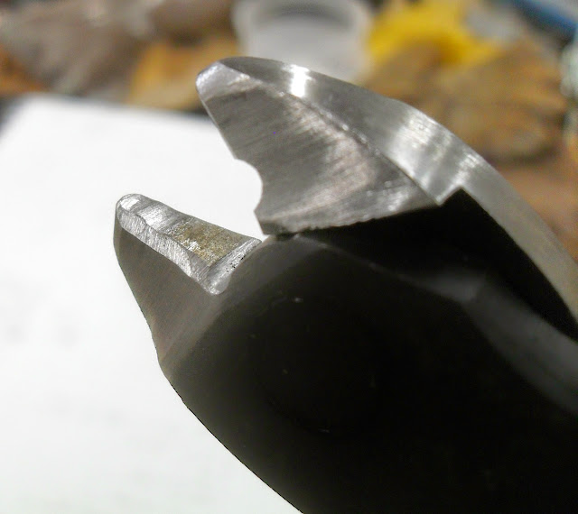

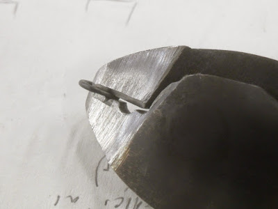

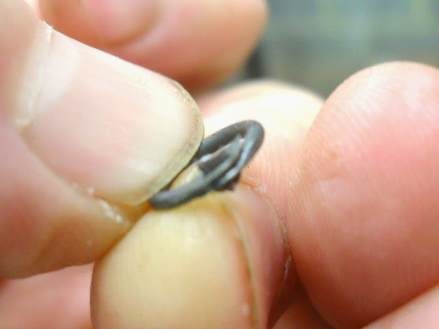

I built a new tool for closing the rings. It works OK.....but it's not all it should be. It started of as a crimping tool from "Horrible Freight" http://www.harborfreight.com/9-1-2-half-inch-...36411.html
...which I modified.

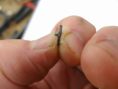

Here is a ring with the rivet placed in the slit.
The closing procedure is pretty straightforward. It happens in two stages. The ring is placed in the first "station" in the tool and given a squeeze. This presses the rivet all the way in and gives the back of the ring a bit of curve.
Then the ring goes to the second "station" in the tool and given another squeeze. This collapses the point of the rivet and any of the surrounding ring material into a nice neat bump.
The problem with this tool is that it is too bulky to close the rings once they are knitted in. It is not so bad on an edge like here in this pic, but getting at a ring that is already linked with four others is too difficult. I am not quite ready to abandon the overall idea of this tool yet, but I think the next one needs to have the two "stations" closer together.

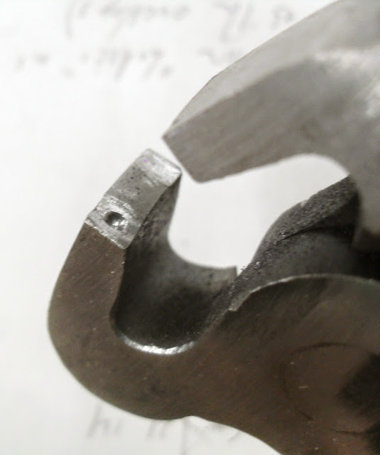

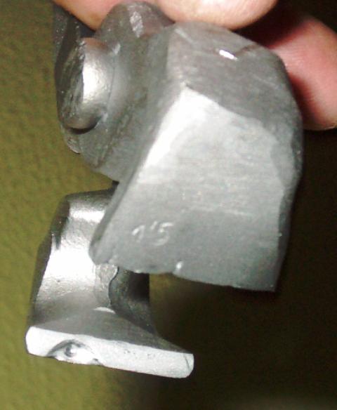

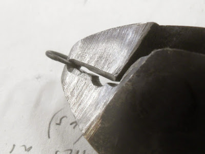

Funny you should mention it. I started in on a new tool right after I posted.
The new tool is based on an end nipper from the same economical source as the other. http://www.harborfreight.com/10-heavy-duty-end-nipper-60815.html
I ground away much of the width, and changed the shape of the jaws a bit to bring bring the working surfaces closer to the pivot.
The rivet driving station is on one side......
....and the rivet closing station on the other. One flips the tool over between operations.
Here are a couple of test rings. I cut these with less "pointy" overlaps because I was having trouble getting the longer points to behave. (so many different problems, and they are all interrelated)
