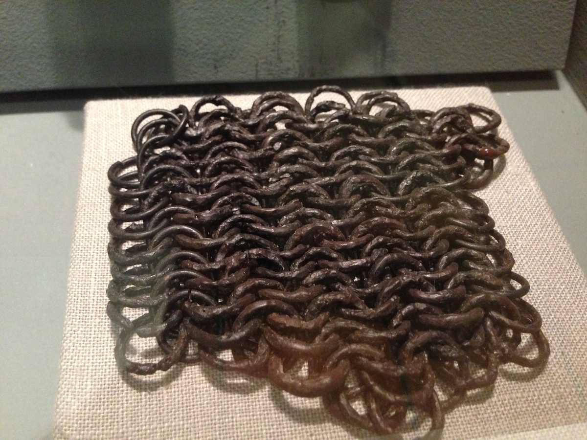

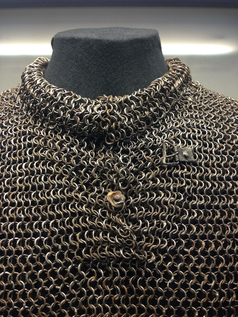

First pic is a fragment described as 'celtic' mail thats on display in Bern and the other some mail attached to a lovely early milanese gauntlet at Sion Castle Museum, Switzerland. Last is a shirt in the same museum, think it was late 15th/early 16th. cant seem to find it in my notes. i have a few more pics I can send if anyone wants.

That first sample is the 6:1 fragment from Tiefenau. More pics? Of course we want to see them.

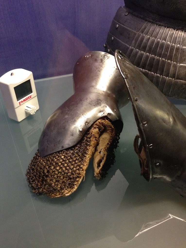

Mark, its hard to tell but is the mail on this mitten riveted?

Sadly I was without my decent camera, just iPhone pics so everything depended on the lighting. I'll do some re-sizing on the shirt pics and post up.
I can see some rivets on the mail mitten but couldn't swear to all of them. Also a bit limited at the mo on doing a zoom on that image so if someone wants me to email them the originals, drop me a line. mark@griffinhistorical.com

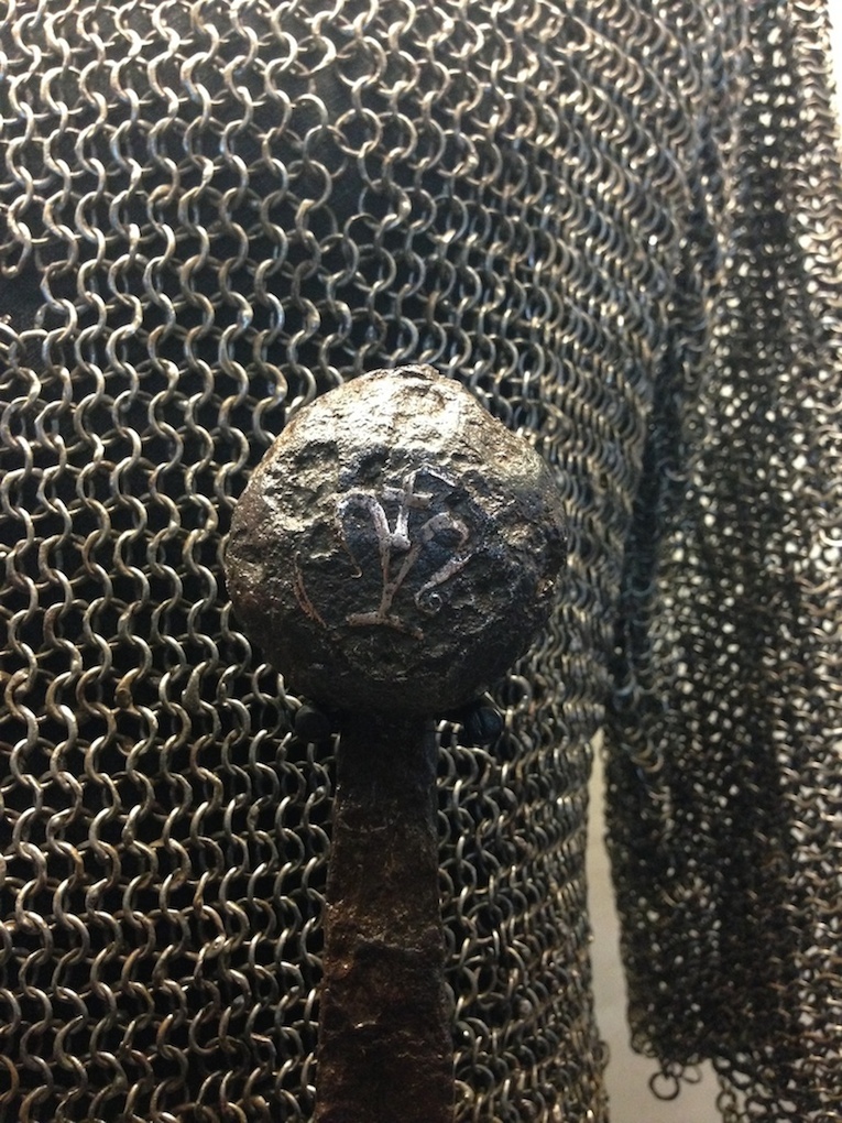

that shirt.
These are also the only pics i got of that Sword too...nice inlay on the pommel. Cant say anything more about it, looks river found.

River found would be a good guess.

Mart, do you have any more info on this mail example.

The definitive work for the Tiefenau 6:1
Müller, Felix, Das Fragment eines keltischen Kettenpanzers von Tiefenau bei Bern, Archäologie der Schweiz vol.9 (1986), Issue 3, pp. 116-123
http://retro.seals.ch/cntmng;jsessionid=18C41...986:9::177

Thanks, so any idea of the approximate age?

From Armour Archive discussion of 6:1 mail -
http://forums.armourarchive.org/phpBB3/viewto...au#p832045
Nate B. wrote:
Fragments of maille found at Tiefenau (near Bern, in Switzerland) were of the 6-in-1 construction. The rings were about 1 cm diameter and a little over 1.2 mm wire thickness. The find is a "massenfund" or hoard deposit dating from the 2nd--to 1st centuries BC. The find is Celtic/Gallic.
http://www.themailresearchsociety.erikds.com/pdf/tmrs_pdf_21.pdf
I.M. Stead wrote:
...but the Tiefenau find has La Tène II and III artefacts, including Nauheim brooches.
Nauheim brooches date from 120 - 48 B.C. according to this reference.
http://vml.de/e/detail.php?ISBN=978-3-89646-301-2
