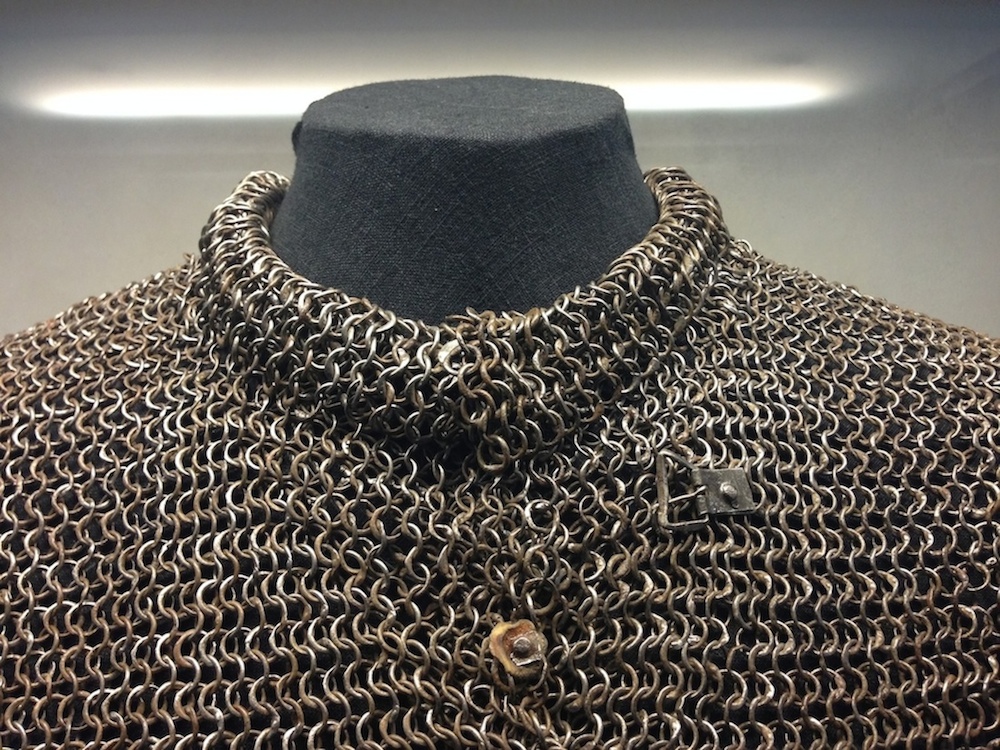

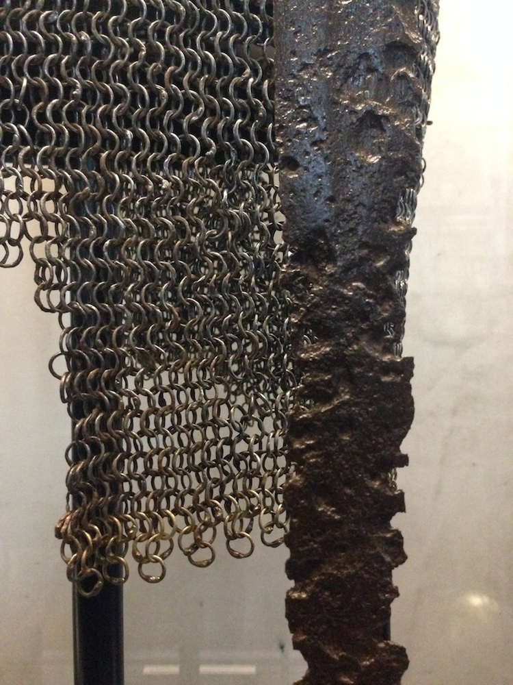

First pic is a fragment described as 'celtic' mail thats on display in Bern and the other some mail attached to a lovely early milanese gauntlet at Sion Castle Museum, Switzerland. Last is a shirt in the same museum, think it was late 15th/early 16th. cant seem to find it in my notes. i have a few more pics I can send if anyone wants.

Mart Shearer
Posted: Tue 28 Oct, 2014 11:28 am Post subject: |
That first sample is the 6:1 fragment from Tiefenau. More pics? Of course we want to see them.

Mart Shearer wrote: | That first sample is the 6:1 fragment from Tiefenau. More pics? Of course we want to see them. | Mark, its hard to tell but is the mail on this mitten riveted?

Sadly I was without my decent camera, just iPhone pics so everything depended on the lighting. I'll do some re-sizing on the shirt pics and post up.
I can see some rivets on the mail mitten but couldn't swear to all of them. Also a bit limited at the mo on doing a zoom on that image so if someone wants me to email them the originals, drop me a line. mark@griffinhistorical.com

that shirt.

Mark Griffin wrote: | First pic is a fragment described as 'celtic' mail thats on display in Bern and the other some mail attached to a lovely early milanese gauntlet at Sion Castle Museum, Switzerland. Last is a shirt in the same museum, think it was late 15th/early 16th. cant seem to find it in my notes. i have a few more pics I can send if anyone wants.
Griff |
Mark, thanks for sending me your pictures, I am going through them, there are a few really interesting one. Here is my first question, there are two gaunlets with intact mail mittens, are these both early Milanese gauntlets? The mail mittens look very similar but the gauntlets are obviously not a pair.
