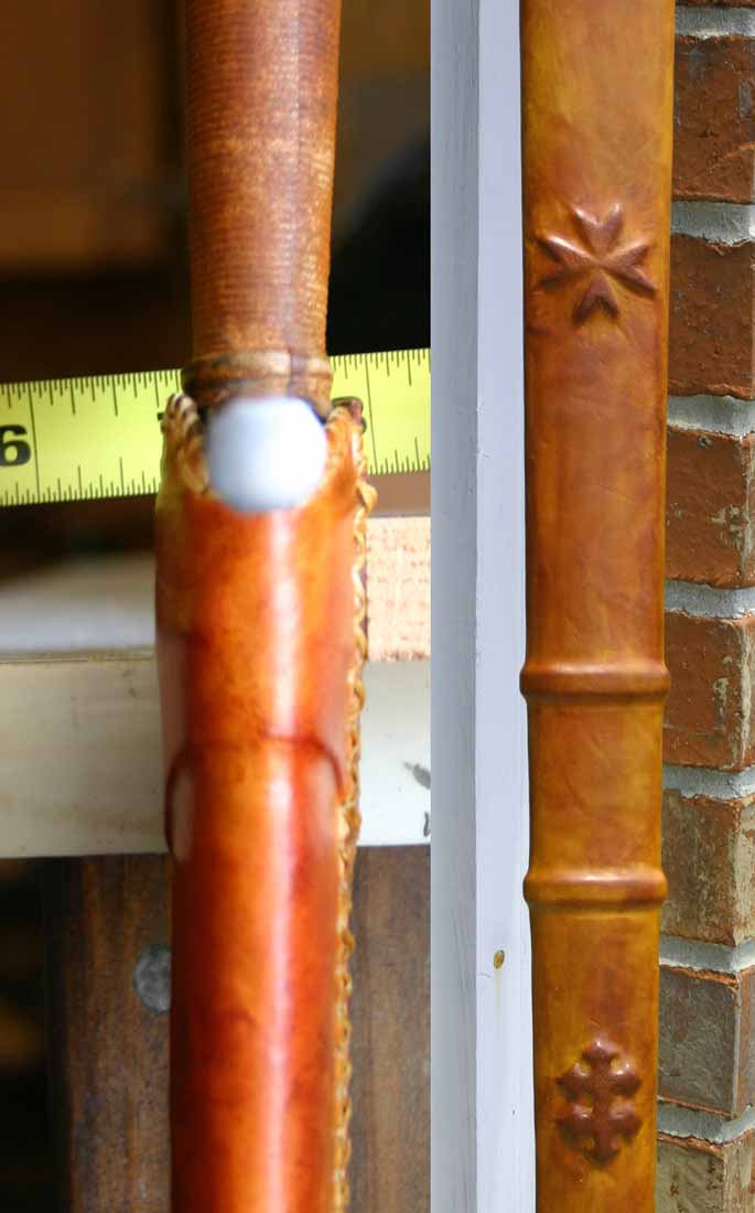

On tightness of fit, I seem to recall some period instruction about "grasp the mount of the scabbard firmly with one hand and pull the hilt". This suggests a little bit of force being required in my opinion.
Of my own scabbards, my children have great difficulty pulling the sword out and adult strangers give me a puzzled look when I hand them the sword in scabbard and invite them to draw it to inspect it. It really only takes a few pounds of force (preferrably between 5 to 10 lbs force) to withdraw one. I have no fear of a sword comming out simply from being turned upside down or comming loose in travel and actually like this snug fit.
I have used heavy wool flannel fabric (100% wool) from Fabric.com. I like the taupe or camel colors as these seem to have the least amount of dye. I fit the cores to compress the flannel to about 50% of its original thickness near the mouth. This ends up working pretty well over time as it loosens or takes a "compressed set" a with oil and age. The unpleasant aspect of doing this with flannel is that I have found it necessary to extend the cloth out of the mouth and to turn it over the exterior like a cuff. It will tend to get caught and tear loose during sword insertion if the wool cloth is only inside the core.
Attachment: 44.9 KB
