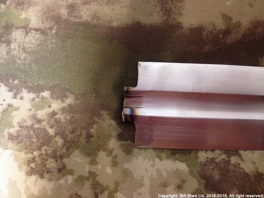

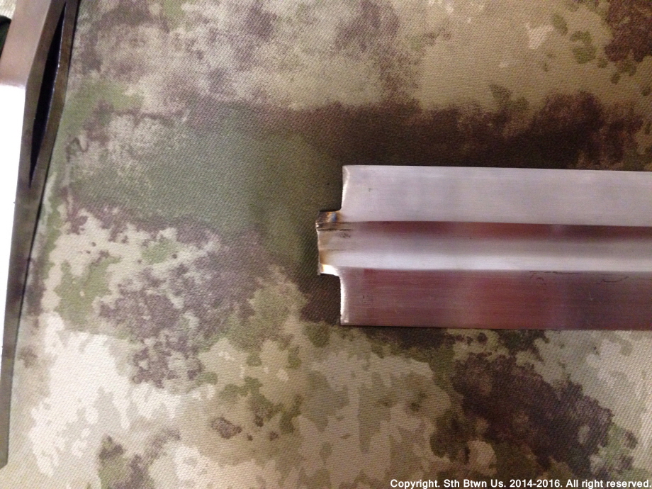

It was not good for cutting bamboo. Anyway it doesn't matter. I didn't care. It could be possible. Because It was double beveled edge.

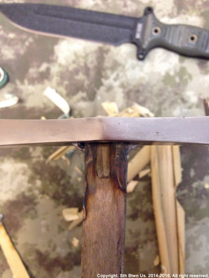

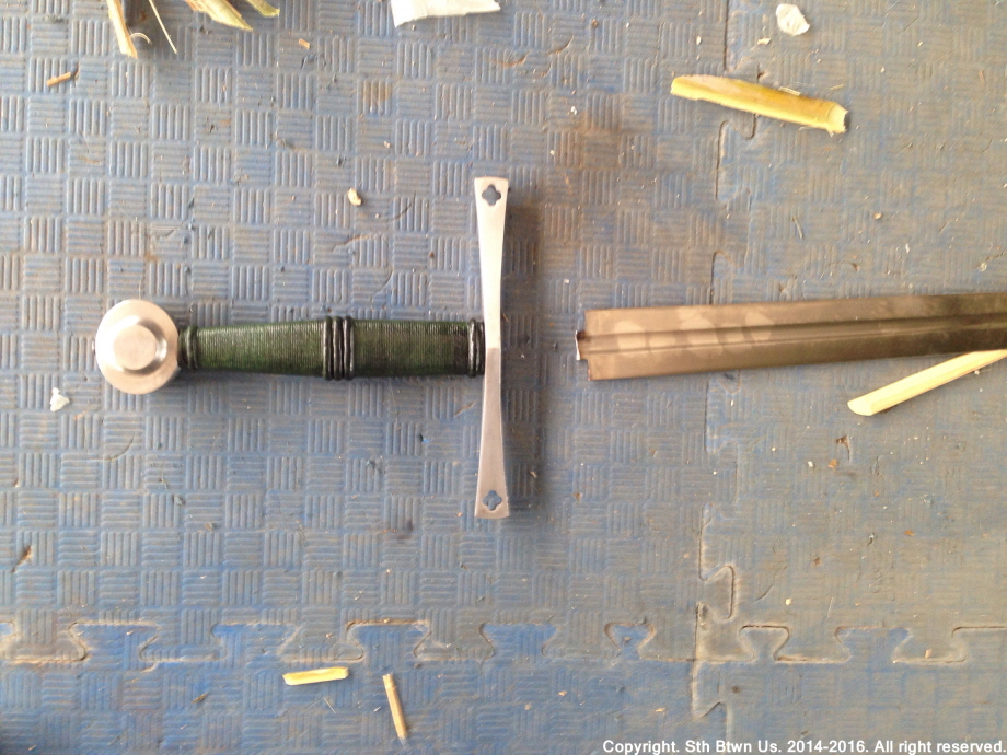

When I cut the bamboo stick 10 times(10 CUTS, Not 10 BAMBOO STICKS), BLOODY RIDICULOUS thing happened. It was broken and broken blade flew away. Even one of member could be hurt.
DO YOU REALLY THINK THIS IS POSSIBLE?? SWORD FOR 10 CUTS?????

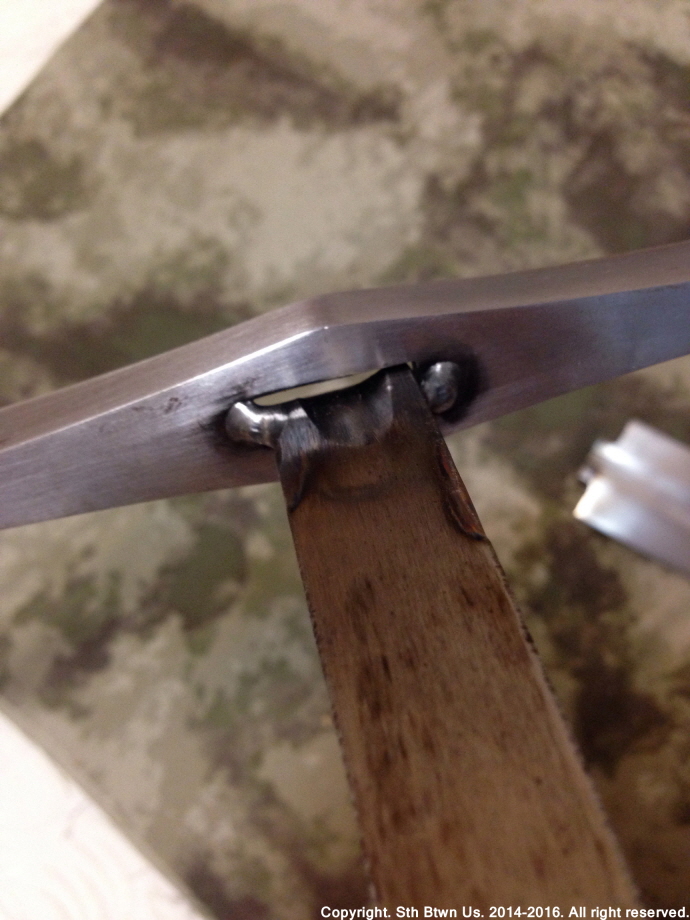

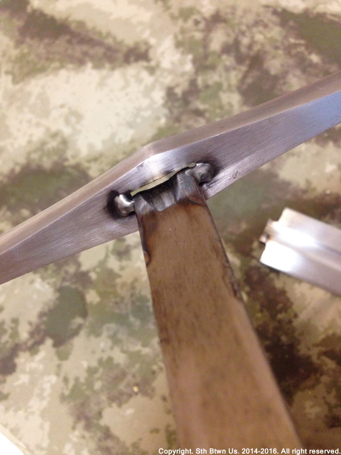

I disassemble the hilt after back to home. And I found the HUGE GAP BETWEEN CROSS GUARD AND TANG. AND IT IS WELDED!!!!! OMG.....
IMO, Tang was heat treated when Mr. Suttles(Sonny Sutters) welded the cross guard and tang. Sonny shouldn't do that.
