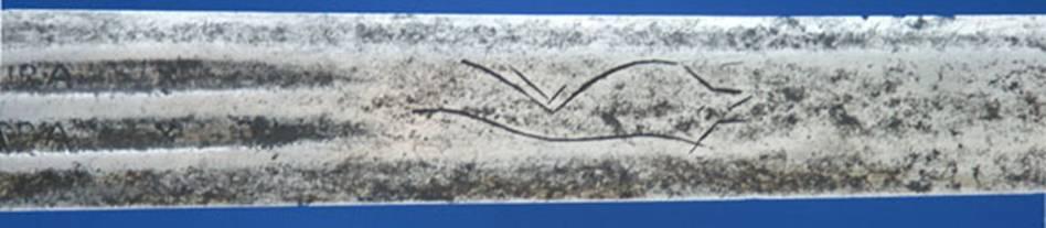

Vladimir R.
Location: Serbia
Joined: 03 Mar 2010
Posts: 6
PostPosted: Wed 26 Feb, 2014 11:11 pm    Post subject:         Reply with quote
I would like to contribute to this topic, this is Passau wolf from the sword in Belgrade museum. Its dating is disputable, but most agree that it is from the 15th century. Could this mark proove or disproove its dating?
https://www.dropbox.com/s/cztzbg8skyyqraw/Belgrade%20museum%20passau%20wolf.png
