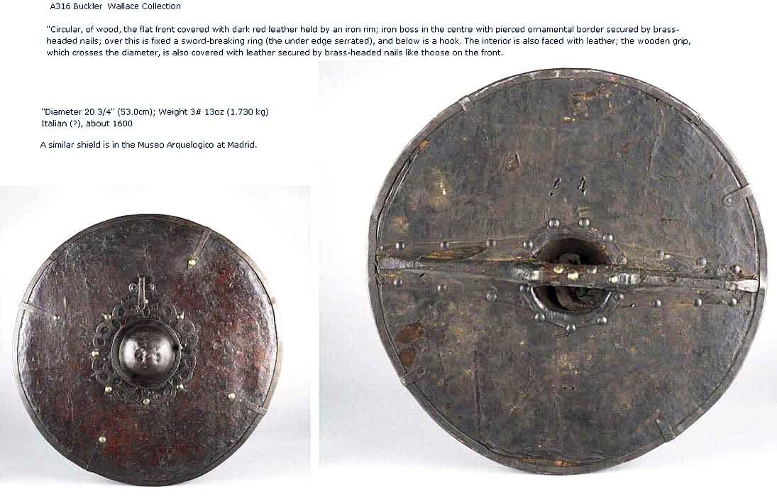

Vincent.........Its hard to find photos of the rear side of original Bucklers, but here's one I found from the Wallace Collection. You can see that it resembles the rear of a Viking type shield. Of course that doesnt mean that it was necessarily typical, but just that it survived. It does resemble several in manuscripts, however.
Attachment: 74.06 KB
Merv ....... KOLR
