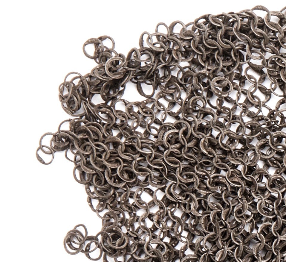

Actually Eric, at least some of the photographs are excellent. You simply have to download the original file from Wikipedia. The image entitled "Ringbrynja_med_halvarmar_-_Livrustkammaren_-_106763.tif" is 6,870 pixels by 5,402 pixels in size, for example. Here's a close up of a section of the mail in the picture, so you can see what that looks like.
 Attachment: 309.66 KB

I didn't get Eric's criticism. I thought he just being picky. Here's the wikimedia site with the larger sizes of that flattened mail: https://commons.wikimedia.org/wiki/File:Pansarskjorte%C3%A4rm,_Alskogs_ka_-_Livrustkammaren_-_19343.tif I would say that it looks flattened. There is a slight bump around the rivet but not pronounced like it usually is. I don't know how to prove it's european other than it looks similar to the tofta coif.

len, your right about this image, its very clear, close and detailed, and there are some other very good images as will but there are a huge amount of armor images and weapons images at the museum, including a lot of really rare armors that do not have close detailed images. Before they were on Wiki I would use the museum database and I guess I am a bit fustrated seeing all these amazing items were you can not see the details.
