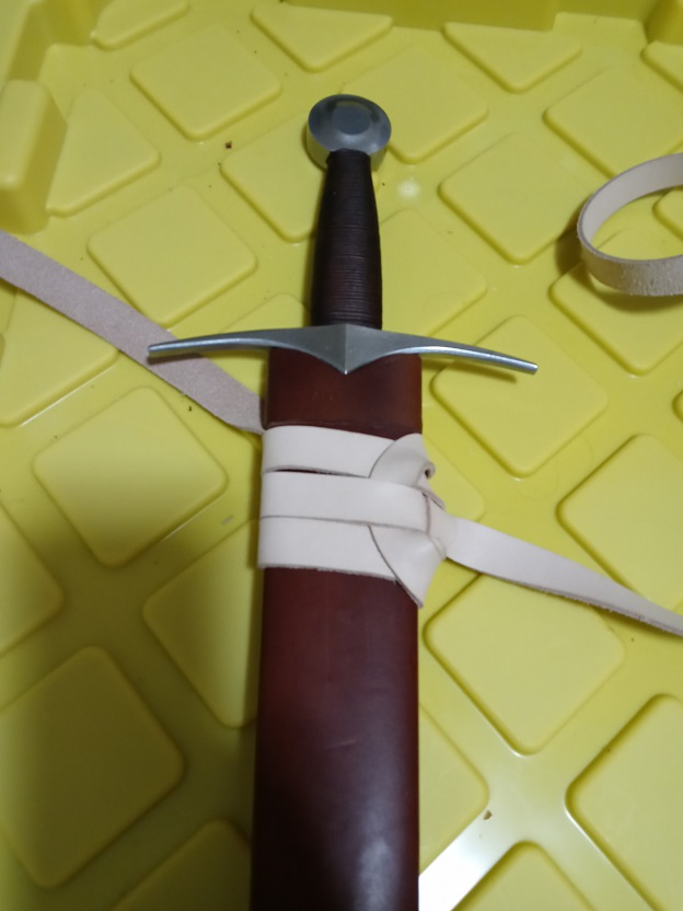

Thank you for the reply Tod. The biggest thing I seem to be having trouble with is that everything seems to be slightly different sizes from everything else.

PostPosted: Wed 25 Nov, 2020 3:26 pm    Post subject:         Reply with quote
Wow, been 2 years! I ended up giving his a try!
This is a Kingston type 15 sword I got from kultofathena. It has a ridge on the throat.
So I got a really long 3/4" piece of 6oz leather. A bit thin, but I was going to tie it, so I thought i'd get it thinner.
I simply followed the pictures and it ended up really good. It is nice and tight and wont easilly slip down. I need to really pull on it. I think if I wet the leather and tied it tight it would be even tighter and woudlnt go anywhere.
Think I will dye it. Not sure if I want to make a whole belt, or have a hook on the back facing strap to attach it to another belt.
