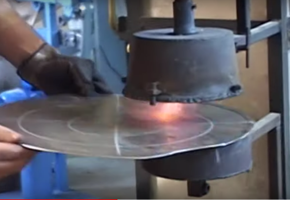

Hello, after reading the guides I couldn't find a forum where to post within those I have access into.
So, here goes.
I am not interested in someone trying to sell me this. Just want to know how to search for this item (which name) if it indeed is commercially available.
So basically, the bottom part moves up and down and the bell on top is the gas fed torch. It's so much better for the heat containment and localization than a torch.
I guess there is some sort of refractory cement making up the walls of the upper bell. This one looks home made but, to your knowledge, is there a commercial version of this device?
Recently, I was advised that this type of mini forge was known as a Clam-shell forge but I cannot find anything using this name. Someone knows about the current one?
Thank you very much!
 Attachment: 606.44 KB
The burner in question [ Download ]

PostPosted: Sun 02 Feb, 2020 2:14 pm    Post subject:         Reply with quote
Hi J
Welcome,
Thank you for the picture, excellent,
not seen a sell through of this,
where or whos is this ?
seen similar principle on a bigger scale, industrial etc, may have been ceramics industry,
wouldn't a clam shell be a hinged piece ?
this one looks localised heat, still wouldn't be as efficient as an enclosed forge, but would give huge freedom on bigger stuff or unusual shapes etc, so a great addition to a work shop,
the old 5" rule seems to still apply

PostPosted: Mon 03 Feb, 2020 9:18 am    Post subject:         Reply with quote
Most of the armour-making community refer to this style of forge as the "Eric Thing" forge. If Eric didn't pioneer it, he was certainly the first to post a blog about his forge: https://www.anvilfire.com/21st-century-blacksmithing/plans/armour-forge/
Many of us have since followed his lead, adapting the idea as needed. Replaceable burner heads/combustion chambers and an adjustable jaw are the key elements.
I believe there are many venturi burners on the market. The T-Rex burner is one that was popular for years. Ron Reil has a web page describing how to build simple venturi burners with little more than a drill press. I've used his plans on multiple forge projects with great success: https://ronreil.abana.org/sitemap.html
-Adair

PostPosted: Wed 12 Feb, 2020 11:09 am    Post subject:         Reply with quote
Lee O'Hagan wrote:
Hi J
Welcome,
Hello Lee,
thank you very much for your answer.
I also think, just from looking at it, this would be great for localizing heat. And considering working in small segments like when you raise a helmet for example would be an ideal use for such a forge.
Also the beginning of such a project is usually flat and later on bowl shaped. Again this would be great for these shapes.
I was also bit confused when I was told about this being referred to as "clam shell". But I guess it's because it closes around the piece.
The photo is taken from a youtube video of certain czech armourer, one of the best maybe, and from the resolution you can tell that it's only a very small crop of much larger still. But I haven't asked him if I can take the screenshot even though it's so small and the source on public domain.
I would draw a picture for my question but this was just much more straightforward.
