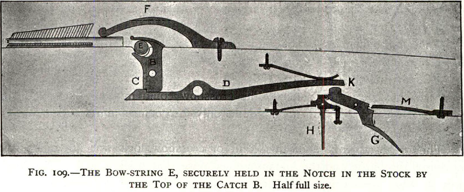

This particular bow fascinated me enough that, given your description gave a sourced book with exact references, I picked up a digital copy. This statement now confuses me, further.
Leo Todeschini wrote:
You also ask if it is possible to load the bow without the trigger being set and so use it as a safety. This cannot be done as the hammer pushes up against lever 'D' and so the catch will be left free and the string would not get caught.
Figure 109, and the accompanying text from p. 170-171, indicates that you can secure the bowstring and bolt into place without setting the hammer. However you're saying that this isn't possible? Is this just a difference in construction between your bow and the bow in the book? Is it something just inadvertently overlooked? Miscommunication of concepts? For reference:
As the string drops into the notch, it presses the projection at A, of the swinging catch B, downwards. This causes the stepped end of the catch B, and the stepped end of the lever D, to interlock at c, as seen below in fig. 109. At the same moment the broad flat top of B, falls over the bow-string E, and holds it from escaping upwards out of the notch, figs. 109, 110.
Fig. 109. The bolt is now placed on the stock ; its butt-end, it will be seen, not quite reaching the notch. The rounded end of the piece of curved horn F, ( f in. wide,) presses lightly on the butt of the bolt and prevents it from falling off the crossbow should the latter be aimed downwards. The top of this piece of horn has a V-shaped nick cut along its centre at F, (see dotted line,) to act as a back-sight. The point of the bolt acts as a fore-sight. As the bow-string is forced to the
notch by the lever of the crossbow, it is pushed under the end o f the horn F. Though the bolt is now on the stock, the b ow bent and the string stretched (fig. 109), the crossbow is safe and cannot be discharged without further manipulation.
Figure 109 shows the string clearly set, yet the trigger is not set; and the accompanying text says that it needs further manipulation to fire. Then it goes on to show in figure 110, with accompanying text, how the trigger is set after the bow is spanned and the bolt in place.

PostPosted: Wed 03 Oct, 2018 4:21 pm    Post subject:         Reply with quote
Hi Ben,
There may well be differences, and perhaps it is a difference in spring weights and I have not handled and original to know for sure, however consider the following.
For the bow to work as PG says, the light hammer must strike the heavy bar and drive it off the catch against its spring pressure using only its momentum, as the spring for the trigger set lever cannot engage during the whole travel otherwise it would always push up against the main bar (as I have done).
I am not saying PG is wrong, but I would say that I cannot see how it could work exactly as described. Please also consider that PG is a good primer and there is much of great value in the book, however don't take everything as gospel.
I hope that helps

Ben Joy
Location: Missouri
Joined: 21 May 2010
Posts: 122
PostPosted: Wed 03 Oct, 2018 7:56 pm    Post subject:         Reply with quote
Thank you for the insight.
While I don't take it as gospel, I can certainly see how it would work as he describes in the book. The hammer's spring and the hammer itself would need to be a bit more "weighty", so to speak, while the locking bar's spring would need to be a bit lighter. The tension of the spanned bow, on the swinging catch, would be enough to retain the bar in place. I've seen similar premises work plenty of times in various mechanical tinkering (namely firearms, no less, and those I'm quite familiar with).
It is extremely worth noting that there's nothing in the book that documents the weights, spacing, etc. with regards to the construction of the trigger assembly's parts. That is extremely frustrating. He could have certainly exaggerated the gap between the hammer and the swinging catch's locking bar; and that would make illustrating the whole assembly that much easier. You'd only need few mm of gap to ensure a built in spanning "safety" with regards to the trigger; and that wouldn't require anywhere near of an extreme in the strength of the hammer and its spring.
That said, I'll have to chalk it up as a difference in construction. Regardless, it's still an exquisite crossbow. If you get a chance to make another one in the future, maybe attempting to exactly replicate the functionality of the book would be a challenging and/or worthwhile venture of research.
