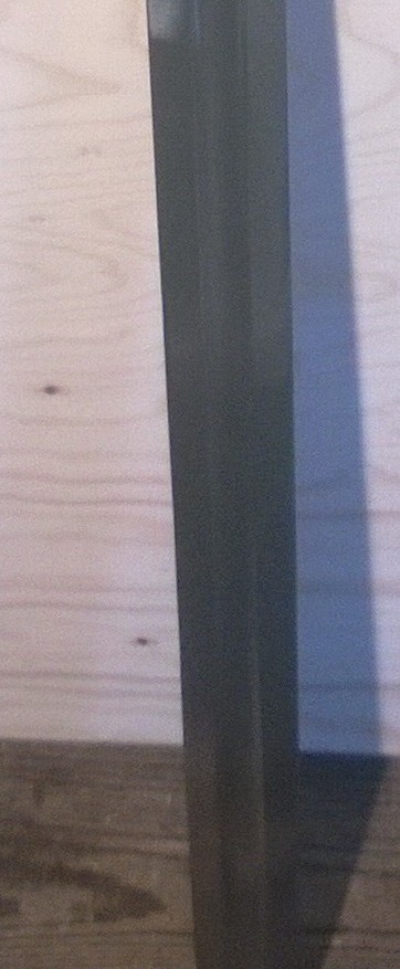

PostPosted: Thu 06 Sep, 2018 6:54 am    Post subject:         Reply with quote
Hi what do you Think i fint want to thin out the fuller it is get to tin dangerus
Vant post the image
 Attachment: 102.93 KB
 Attachment: 140.83 KB

PostPosted: Fri 07 Sep, 2018 1:30 pm    Post subject:         Reply with quote
Yes, we thrust in reenactment, although it might depend on the rules of the local group. Are you a member of a group or do you plan to join one? Different groups may have variations on their rules. But generally a 2mm edge with a point rounded like a coin is considered safe.
Question though, why do you want to shorten the blade? 98 cm is probably about the most common length on most single handed swords I've dealt with, if you shorten it you'll be at a severe disadvantage meeting a majority of reenactors.

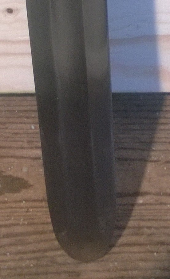

PostPosted: Sun 16 Sep, 2018 7:23 am    Post subject:         Reply with quote
It got perfect not so clumpsy anymore it feels perfect
 Attachment: 818.91 KB

PostPosted: Thu 20 Sep, 2018 8:50 am    Post subject:         Reply with quote
If it was too heavy, grinding off excess weight without taking down the length would have been better, although it would require a lot of skill and/or luck to not screw it up.

no think its get to dangerous thin it don't get safe two mm if the fuller is gone

PostPosted: Sun 07 Oct, 2018 10:36 am    Post subject:         Reply with quote
Yes you need to keep the edge 2mm, but you don't thake away the mass there. If you take mass away you're usually taking it from the thick parts of the center.
