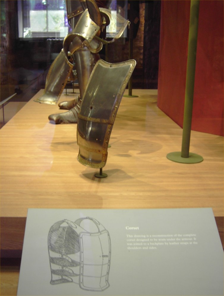

The piece was on display in the Tower about eight years ago. Here is a photo with a reconstruction from a slightly different angle than the picture already posted in the thread.

I do not know if the sketch at the bottom of the picture is valid but it seems to me that the back plate also had a central bolt. Does anybody have a picture of the back of the armour?
