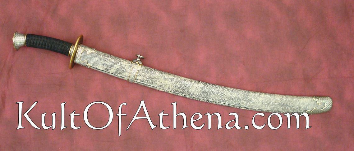

Hello
What is the tang on the Hanwei Song sword like?Is it a so called "full tang"?The only tang on a Hanwei sword i`ve ever seen was on a Cromwell and it was rather thin.Anybody own one?Thanks in advance

While I haven't seen the sword you mention, I've owned three of the Hanwei/Tinker swords, and all three had nice, thick, beefy tangs.

I've looked at that Chinese sword, too, Double-K ... and maybe like you I'm drawn to the
shape and design of the blade, not to mention what appears to be an attractively detailed
scabbard. It appeals to the saberesque tastes I've developed over the last half-dozen
years ...

Tinker /Hanwei swords have a very different build than many swords sold by Hanwei/CAS.
Some of them three piece sword arrangements with a stub tang, middle and welded rod.
You really just don't know until having one apart.
