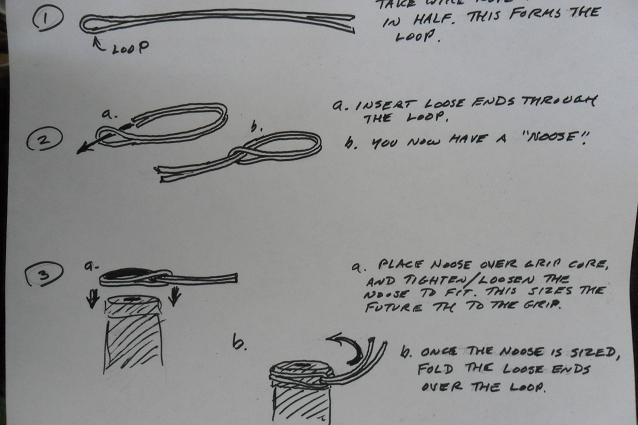

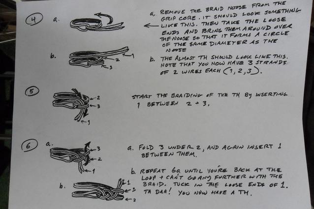

PostPosted: Wed 22 Jun, 2011 2:56 pm    Post subject:         Reply with quote
OK, let's see if this will work...
If it does, I'll post some comments later.
--ElJay
 Attachment: 53.81 KB
 Attachment: 62.41 KB

Thank you very much, Eljay! This was an incredible post. I am going to try it with some paracord tonight!

Eljay, you are a very kind genius. Thank you for taking the time to ilustrate that and for sharing this info.
I just did my first TH knots in paracord the way you illustrated. After a few attempts, here are the results:
The one on the left is just how you described; it created a 2 strand TH by folding a string in half.
I looked at one of my smallswords (The 3rd 4th and 5th picture in my first post) and saw that it is a four strand turks head. I took two strings and folded them as you illustrated and I came up with the four strand TH knot on the right.
Here is the back of the two strand turks heads, showing the loop that I thought was a tie off:
Here is the back of the four strand, showing the same loop. You can see the loops in both these images look similar to the "tie off" images on my swords, especially in the 5th image from my first post.
Now I think I know why they did it this way - it is much, much faster. I did the 2 strand TH in about a minute. The four strand took longer because I had to keep the strands from crossing. If I had done it the "nautical" way as I did with the wire and paracord examples in my fist post, it would have taken about 15 minutes for the two strand, over 30 minutes for the four strand, and over an hour for the five strand wire.
I do have one question. How do you end up with the the correct size for the grip? I sized it as you listed in step 3.a of your first pic, but after braiding the TH, the diameter gets smaller. Do you have way of sizing this, or do you just stretch the TH when you're done?

To answer Carl's question about sizing the grip: I find that if you don't get the noose tight, but leave a space between the noose and grip of about the thickness of the wire rope being used, that you'll be pretty close to a tight fit when you're done. You will probably need to do some stretching of the TH as well.
The whole thing of how big a gap to leave between noose and grip is a matter of experience and preference. Some may prefer an unstretched TH (larger gap between grip and noose), others like a stretched TH (smaller gap between grip and noose). Practice, practice, practice.
One other thing: when you do a 4 strand TH, you don't need 2 pieces of wire. Just start with one really long piece, but fold it in half twice. The second fold will form the loop. You'll find it is easier to keep all of the strands in place this way when braiding the knot, as two of the strands will be attached to each other.
--ElJay
