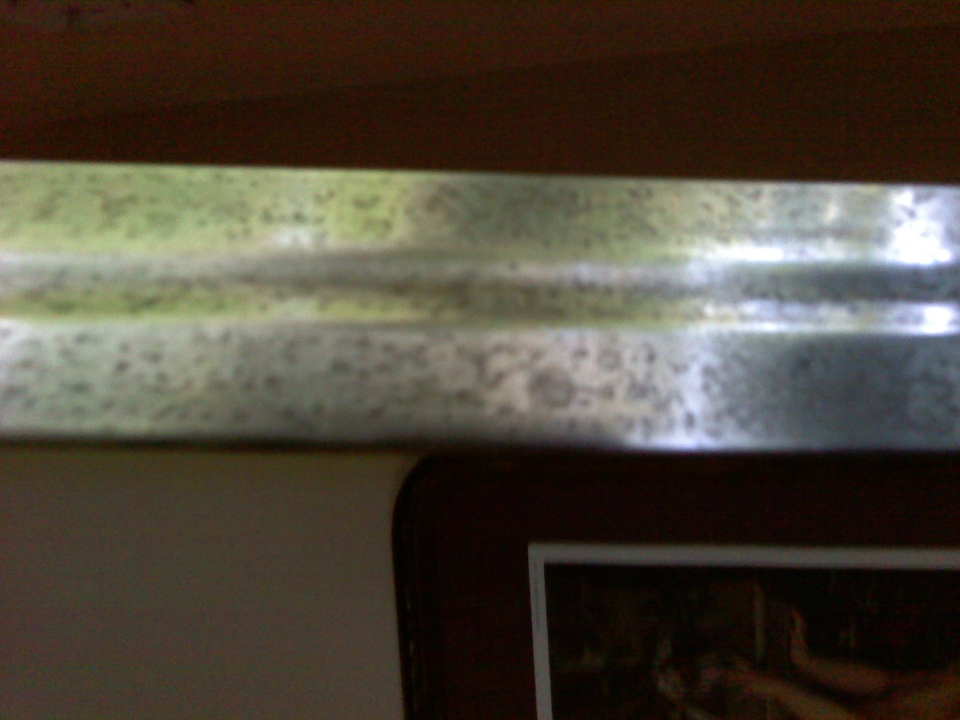

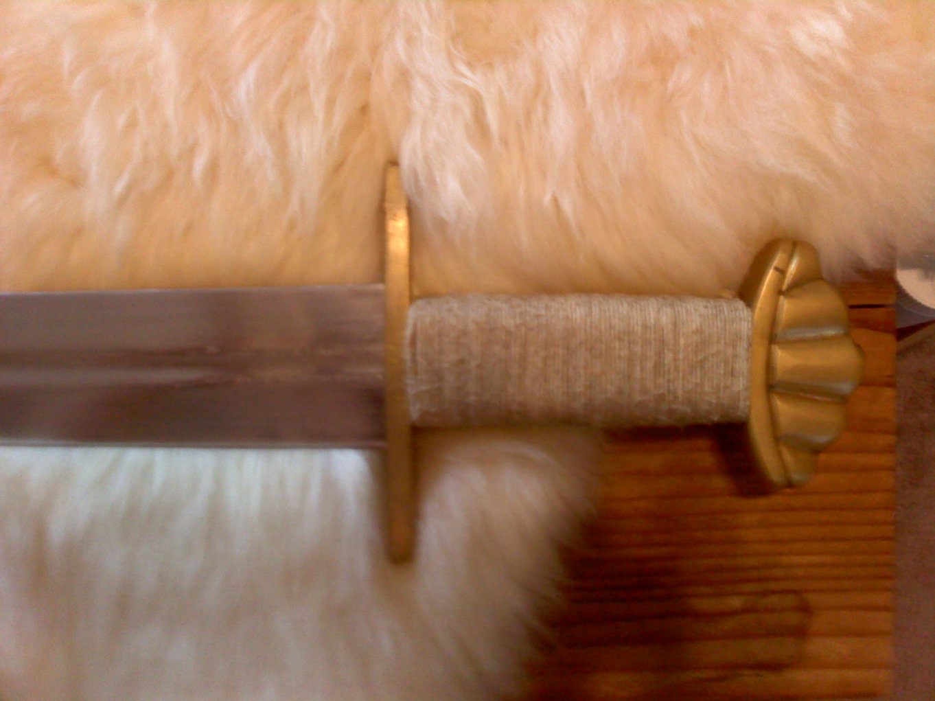

Here's a picture of the blade finish after antiquing, and another of the hilt, which doesn't look so off center in this picture. Sorry they're so blurry. I had no camera, so I took these from my cell phone.

I think Any sword is an entrance into another and interesting world, and this one after the work looks better than it did, so I'd give it a thumbs up!
If you ever have the binding off the handle, you could taper the grip a bit narrower at the pommel end, that wouldn't hurt.
Do you have any "finish" on the hemp cord?
If not, a rub with some beeswax will give it a bit of a polish but won't make it slippery, and will hold down the hemp fibres.
I think in this case the blade looks a lot better aged as well!
