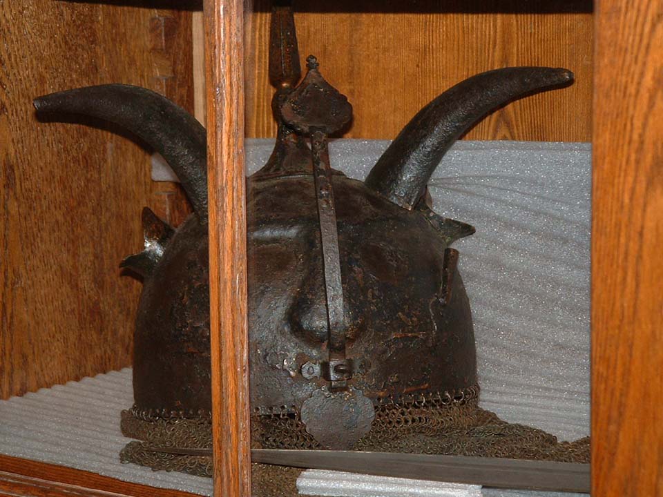

Hello All,
Sorry for being brief, but I just wanted to know if anyone knew of such helmets.
I should introduce myself a little better. I work as a deckhand aboard an escort tug in my hometown of Hantsport, Nova Scotia, Canada. As a hobby I research history, a very wide range, but my general interest is Nova Scotia and basically the unspoken elements of our history. It is in this that I found these helmets.
I have a general understanding of weaponry and armour of the ages, but am by no means an expert. My only knowledge on these helmets is that they exist. I do not know age, who they belonged to, nothing outside of they where donated as a group from the same single source. The donor wished to stay anonymous from my understanding and has since passed on. I only became aware of them about 16 months ago, the owner has had them for about 15 years... the donor died about then as well.
Here is one pic, apparently I will need to resize them. They are all high res pics.
Regards
Dave
 Attachment: 126.85 KB

I am no expert, but I believe its Indian. Whether it is Islamic or Hindu states, I don't know. Maybe Hindu since it depicts a person/devil/demon/ god? Islamic may have Quranic verses engraved or chiselled or with floral or geometric designs.
Indo/Persian perhaps. Actually, it other than the (cerimonial?) horns, it appears to be a pretty common helmet, not medieval I think, as these were in use in up to the 18th and 19th centuries, I always thought. The sliding nasal, plume holder, hemispherical dome, top spike and chainmail camail is all typical in these Indian helmets.
I am sure someone much more knowledgable than me will chime in.
Just saw the secon picture. Hisham is right on the money with the shot of the early 19th century Indian "Khud" helmet.
Pretty cool looking helmets!
Any words of wisdom Hisham?

Hi Dave,
Thanks for the pictures, that helps a lot. :)
Well, I am sorry to say that they have nothing to do with Nova Scotia !
They are a form of helmet called a Kulah khud, and they are probably from Persia. Indian forms of the helmet are generally a little different. However, Hisham is probably better equiped to answer more on these that I am. As to age , I really am not much of an authority on these, though I have handled a few, and I would suggest that they are probably 19th century.
Sorry that I cannot help you more, but I hope that this helps a little bit.
Regards ,
Russ
Dave,
Very cool! Like everyone else is saying: Indo /Persian. A closer look at the mail might help with the dating. The later stuff will have butted mail but the earlier ones are,I think, more likely to be riveted.

Hello All,
Thanks for the many quick responses. I knew they had nothing to do with N.S. proper, but these are the treasures of the hobby. Exactly why are Persian/Indo helmets in N.S.? I figured they ceremonial but was unsure.
My interests is to try and find answers for the people who show me these oddities.
I will be able to better photograph them this spring, as the owner is willing to take them out of the cabinet and allow me to photograph them from many angles.
I will recrop the other pics, though I have none at this point in any higher detail.

Hi Dave,
As has been pointed out, the helmet you have there is Iranian and dates to the 19th century. As it happens we do have an expert in Iranian armour on the Forum: Manouchehr Khorasani. As it happens I own his book "Arms and Armour from Iran" (which a few other members of this forum contributed to as well), but its a massive thing so it will take me a while to find the info. In the meantime, check this out:
http://www.oriental-arms.com/item.php?id=2108
http://www.oriental-arms.com/item.php?id=2160
http://www.oriental-arms.com/item.php?id=1303
Since these helmets seem to be mainly 19th century, my guess that they are either parade helmets, or they were made to be sold to Western Tourists.

Hey All,
The helmets... Do you think they are just individual ones collected? or would they belong to a group?
All I know is they were acquired in a group by the owner and he has put them in care of a local historic site which has nothing to do with their origins. They keep them in a back room in a china cabinet and know no more than I ave related. They have no idea on their origins etc, and actually were hoping someone could someday tell them about them. They don't display them in the main area, they are in a back room.
One is very intricately carved/etched... one is older looking and the other lacks horns, but has plume holders... I guess I am asking if each in their styles denotes rank, position, purpose etc? or are they just for show?
