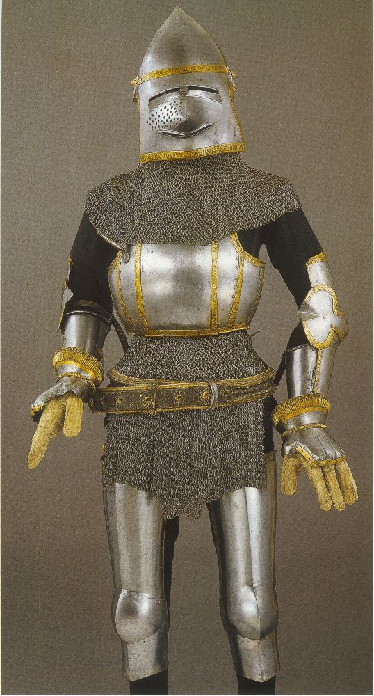

PostPosted: Sat 21 Feb, 2015 1:11 pm    Post subject:         Reply with quote
Searching under armour polish throws up a few threads about this, though mostly later armours and not low-medium quality so maybe not too useful:
http://www.myArmoury.com/talk/viewtopic.php?t...mor+polish
http://www.myArmoury.com/talk/viewtopic.php?t=20995
http://www.myArmoury.com/talk/viewtopic.php?t...=polishing
The Churburg armour is quite bright, again not low-medium end at all.
I am sure I have seen other posts on here asking about this too. Have a search and see what comes up.
I suspect little of the lower quality armour survives (in a condition that can tell you much about the finish)
 Attachment: 138.98 KB

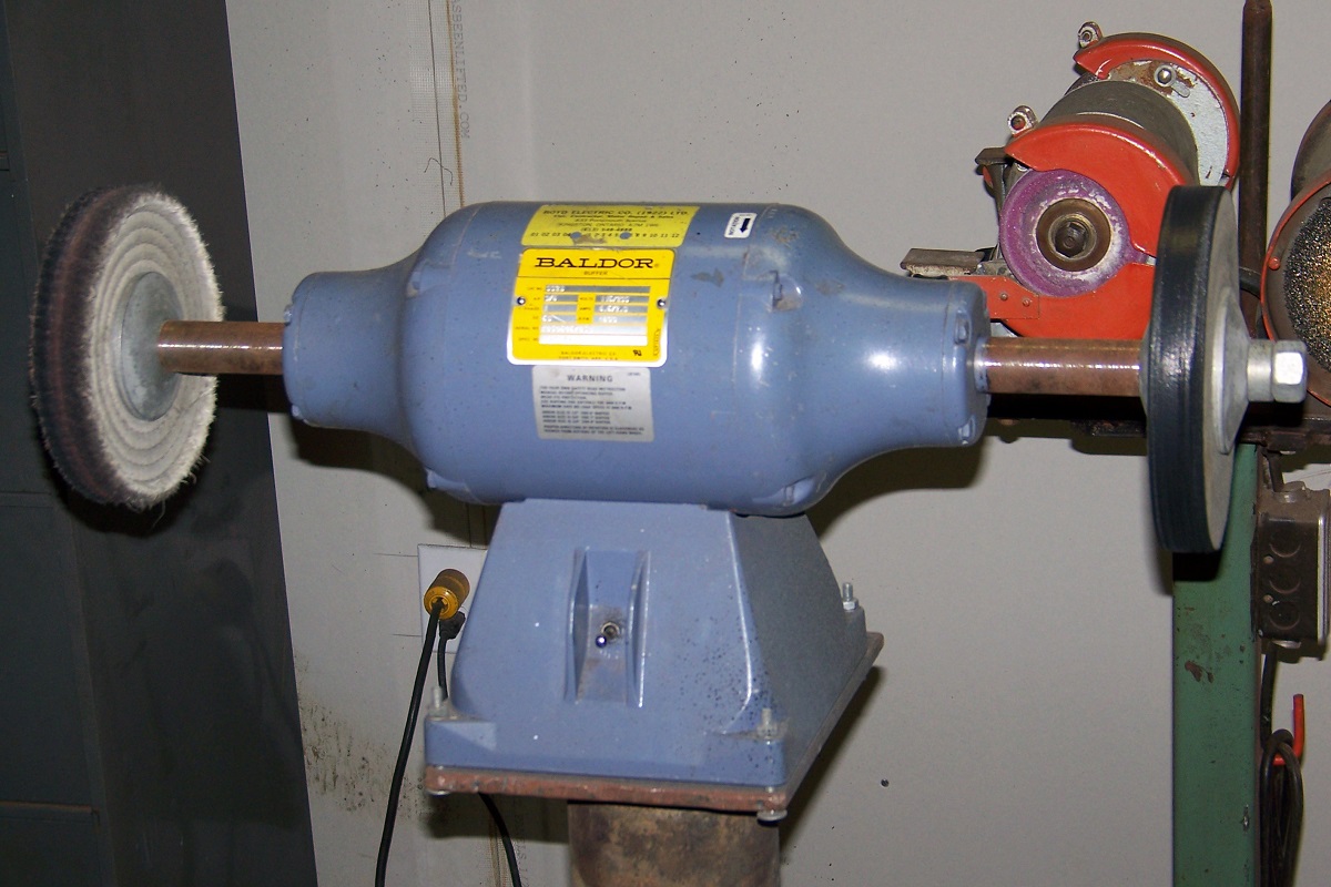

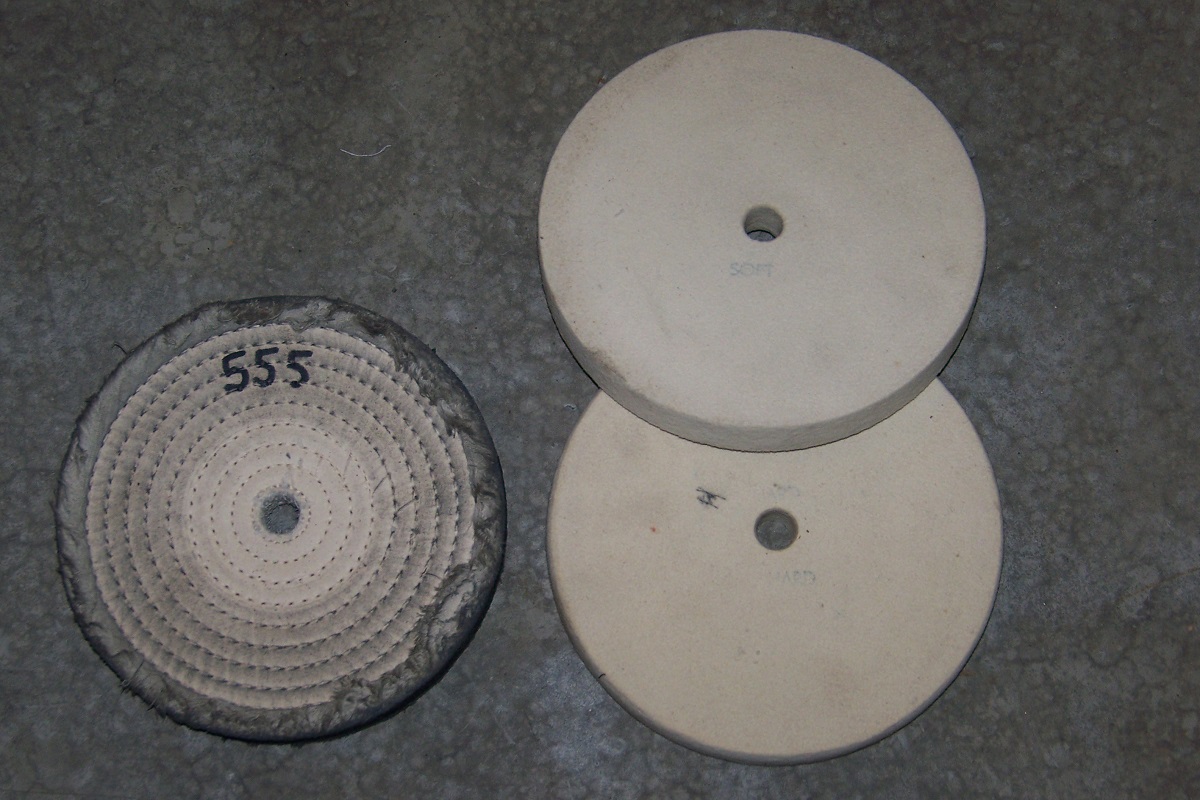

PostPosted: Wed 25 Feb, 2015 6:04 pm    Post subject:         Reply with quote
The finish James shows is good at hiding slight imperfections and can still be quite shiny. Without that texture every imperfection even in the polishing itself is revealed.
Best and quickest way to polish I found is with a Baldor or similar buffer. The shafts are long and thick and the motor is vibration free so it does not transfer marks to your work. The 555 polish will give the highest polish you will ever need.
Use only one wheel for one size of grit polish then use soft or[img] hard felt wheels to finish.
With the buffer wheels free of guards and well out from the motor you should be able to reach any part of an object.
Works well on sword blades.
Of course this set up is not cheap, over $500 for a buffer and felt wheels run $80 or more and then add your polishing compounds.
