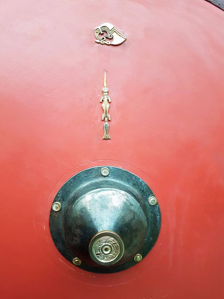

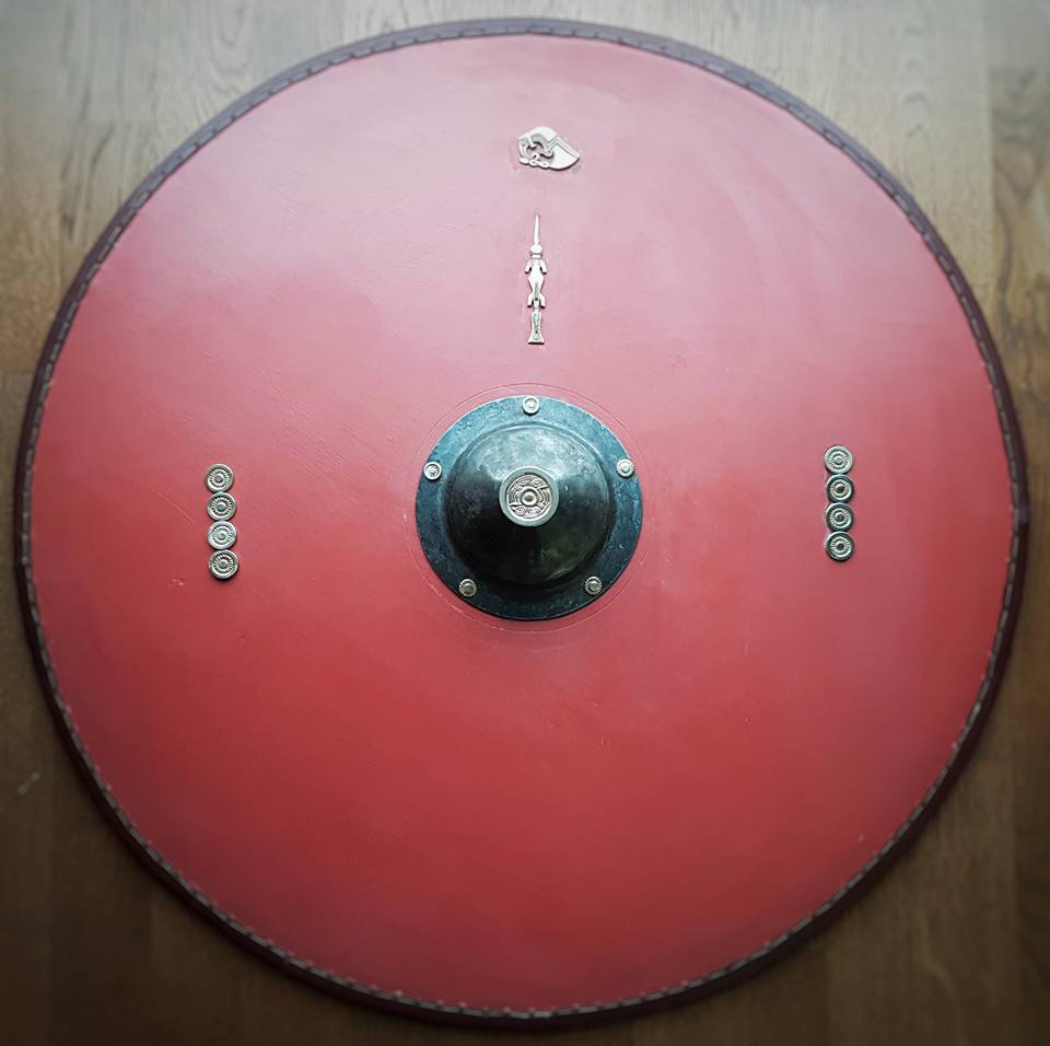

My reconstruction of the 6th century shield from Grave 21/868, Tranmer House cemetery at Sutton Hoo, based on details published in the site report and a British Museum technical report on the construction.
The board is ash, as was the original, glued together with cheese glue made according to the recipe given in Theophilus. Ash is not a common wood for shields but 6 of the 7 shields from this cemetery (where species has been identified) were ash, with the other being oak, which is even more unusual.
This may be an indication that the shields were made for burial, not for combat. The planks are 8mm at the boss, thinning to 5mm at the rim.
In the case of this particular shield, the grip on the back was held in place with rivets which were never peened, so the acted more like pegs. Again, not something expected in a shield which saw use.
The fittings are copper alloy, gilded and with silver sheet soldered to the surface in parts as per the originals. All done by Dave Roper of Ganderwick.
The coverings of leather are glued on using cow hide glue, the one on the rear being applied after the fittings were placed.
The front covering was painted with a gesso made of chalk, powdered clay and hide glue as the original had traces of both calcite and aluminosilicate between the fittings and the board. I mixed some red ochre pigment from the ancient iron mine at Clerewell into this, which gives the gesso it's colour (although there is no evidence for what, if any, colour was added). The gesso layer was then sealed with a layer of beeswax varnish (beeswax and tallow) as beeswax was also found between the board and the fittings.
The stitching around the rim is with some waxed, handmade hemp thread.
Overall, quite pleased with the final results and it was interesting to bring different period methods together.

Absolutely remarkable, Matthew!

This is amazing. Outside of this shield and the one from the main Sutton-Hoo mound, were there any other shields excavated?

There were eleven shields in total at Tranmer House (you can find details of them in this British Museum technical report :- https://www.britishmuseum.org/pdf/BMTRB_5_Bullock_et_al.pdf)
10 of them featured some sort of decorative mounts, this one being the most complex. One other had a lozenge shaped mount as well as disc headed mounts and 8 others just had disc headed mounts varying in number from 2 to 6.
In the mound cemetery, I think that Mound 17 (the young prince and horse burial) is the only one apart from Mound 1 which still had a shield when excavated. It had a simple boss and four large disc headed mounts.
