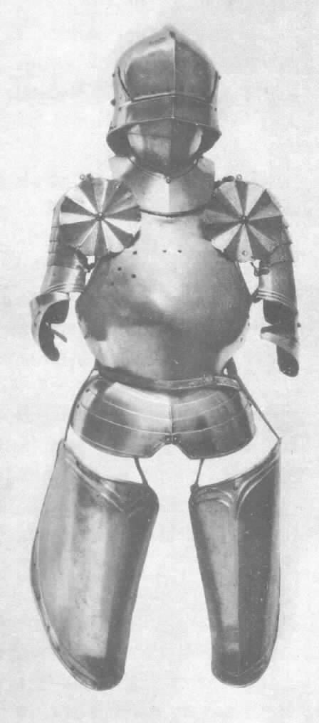

Does anyone have any evidence of a late 15th century Gothic breast plate manufactured from a single sheet? I have no references in any of my texts. In particular, I really like the look of the Manning Imperial Gothic harness, and would like any advice as to its suitability for a late 15th century kit.

I thumbed through some of my books and found 2 harnesses with single-piece breastplates. Both were fluted to create a faux-two-piece look, but it was obvious they were single-piece.

Posted: Wed 11 Apr, 2007 5:38 am Post subject: |
Bill Grandy wrote: | Could you scan those, Chad? I would be very interested in seeing them! |
I re-looked at them, and one of them is two-piece. The photo is just so washed out and poor that you can't tell that they're separate pieces. Here's the other one, though.
Attachment: 45.57 KB

Bill Grandy
Posted: Wed 11 Apr, 2007 9:50 am Post subject: |
That's really neat. Thanks, Chad!
HistoricalHandcrafts.com
Posted: Wed 11 Apr, 2007 12:27 pm Post subject: |
Bill Grandy wrote: | That's really neat. Thanks, Chad! |
I actually love the sallet on that harness. If I had one made, that would be the one.
Bill Grandy
Posted: Wed 11 Apr, 2007 9:39 pm Post subject: |
Chad Arnow wrote: | Bill Grandy wrote: | That's really neat. Thanks, Chad! |
I actually love the sallet on that harness. If I had one made, that would be the one. |
I'm feeling the same way.
