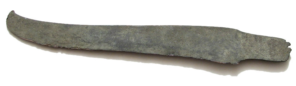

I just purchased this, and was told it dated from the copper age, approx. 3000 b.c. It's 6.5 inches in length, and non-magnetic. Can anyone, based on the design and age, give me a clue as to its place of origin? Can anyone point me in the right direction to find out anything more about it?
Can I give you any more info about it that might help in its identification?

Sorry...typed it in a hurry. I meant "non-magnetic". By its weight, I'm quite sure its metallic Happy Probably copper or bronze, though I don't want to clean it to find out.

Possibly is it an "east-alpine" (means the area from Autria to the Carpathian basin, with Slovenia, Northern Croatia and Hungary) bronze knife, (1000 - 900BC).

Yup, most likely eastern Europe, as that's where most bronze age artifacts come from these days. I must recommend against collecting these artifacts, as they are being excavated illegally, which results in the destruction of important ancient sites. For artifacts of this period, it's best to stick to collecting reproductions and admire the originals in museums Happy

Based on the design (tip up, short tang, VERY thin edge and comparitively thick spine) I figured it might have been a filet knife of some kind.
Also, is there any way to distinguish copper from bronze without necessarily cleaning it?

This is a knife-form from the later bronze age - non alloyed copper blades was definetily "out" at this era! Cool

It's possible. Although remind that bronze artifacts were very expensive in those days, so someone only had one knife, if he could afford one at all. So it's quite likely they were used for all sorts of tasks, like a modern pocket knife. There are a lot of different blade shapes though, which indicated different uses. B.t.w. the curved tip is a result of repeated hammering of the cutting edge to sharpen it.
As Steve mentioned, everything in this period was bronze. Single edged knives appear in Europe somewhere in the middle bronze age. Before that, knives were in the form of symmetrical double edged daggers, of which the earliest examples were copper. There are single edged copper knives though, but I only know them from Egypt.
