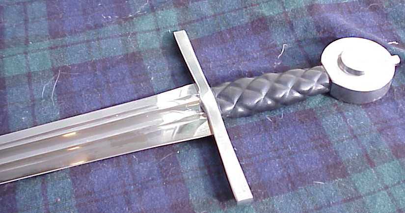

I have recently been experimenting (purely for curiosity's sake) with the heavier end of the historical range, and having played with them sufficiently to answer my own needs, these two swords are now available for sale. They are not being offered through Bladeart as they would normally be, and Larry likes light-weight stuff. WTF?! This gives me the opprotunity to sell these peices directly, so they are on offer here. While both swords are technically 'used,' having been used for test cutting, but are provided in as-new condition.
The first sword-
Type XIV sword in the style of swords of the 13th-14th century.
Overall Length 37-5/8 inches. The 30-5/8 inch long 5160 spring steel blade is 2-1/4 inches wide at the base, and tapers rapidly in profile to 2-1/8 inches wide giving the base of the blade a 'flared' look. The blade then tapers to approx 1 inch wide 2-1/2 inches from the point. The blade is approx. .240 inches thick at the base and distal tapers to approx .07 inches near the point. The distal taper is convex for the first 5-6 inches. The base of the blade features a central fuller at the base approx. 10-5/8 inches long by 1/2 inch wide that extends under the guard and onto the tang. The cental fuller is flanked on either side by 1/4 inch wide fullers approx. 10 inches long. The blade is marquenched and tempered to approx. HRc53. The mild steel guard is 7-1/2 inches wide, is 3/4 inch across at the center. The base of the blade is counter-sunk slightly into the guard. The guard is lightly cusped at the center and flares slightly towards the tips of the arms. The arms taper in width on a convex line towards the tips to approx. 5/16 inch at the ends. The hardwood handle is approx. 1-1/4 inches wide at the base by 5/8 inch thick. The handle thickens to a maximum of approx. 3/4 inch before tapering to approx 7/8 inch wide by 5/8 inch thick at the top where it meets the pommel. The wood is strongly carved in a diamond pattern, then covered in black chrome-tanned leather which is pressed into the carving. This provides and excellent grip which is comfortable and non-abrasive in use. Length of the handle is 3-3/4 inches. The pommel is of Oakeshott's type 'K,' being a flat disk with raised bosses in the center. The mild steel pommel is 2-1/2 inches in diameter, with the main disk being approx. 5/6 inch thick. The central bosses are approx. 1-1/4 inches in diameter and the pommels maximum thickness is approx. 1.09 inches. The pommel is slotted approx. 1-3/4 inches deep to fit over the end of the tang. The spring-tempered tang is then reduced to 1/4 inch in diameter and threaded to SAE1/4-20. The pommel is counter-sunk at the top to admit approx. 1/2 inch of thread engagement on the cylindrical 3/8 x 7/8 inch nut. The nut is cross-bored so that a 1/8 inch rod can be used to tighten or dismount the hilt.
The sword's weight is approx 3 lbs. The Center of Gravity is approx. 2-3/4 inches from the guard. The Center of Percussion is approx. 20 inches from the guard. The location of the Primary and Secondary nodes in the hilt is impossible to determine, as any part of the handle that is gripped feels like the primary node. In cutting the sword transmits no discernable shock to the hand. Despite the close COG the sword tracks very well in cutting and well in the thrust. The sword feels deceptively light and lively due to the close COG and high Polar Moment. The sword is provided with a black leather scabbard with leather locket and chape. US$850 Plus shipping.
Sorry for the photo quality!
