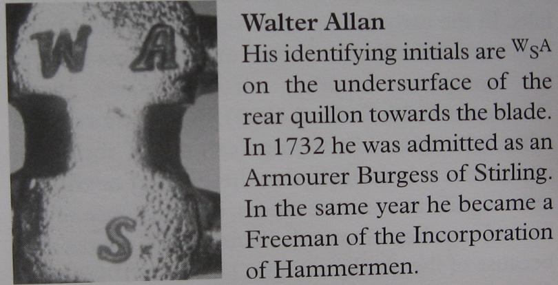

I dont believe a journeyman would have been allowed to sign a piece, that status only coming when he'd reached the rank of Freeman. Vince & I have bantered back & forth as to whether it might have been possible that James Grant could have signed some of his Masters pieces (upon reaching the rank of Freeman in 1759 .... Walter died in 1761), but it's impossible to know for sure ?
If Walter had fallen into ill health, late in his life, one wonders how strict a shop like his would continue to adhere to the guild rules in this matter ? (keeping customers happy and knowing the quality name is still running the show must have been of paramont importance to businesses such as these)
Would an artist like Walter even allow anyone else to sign his name ??
Yup, we need a time machine for sure ;-) Mac
*Photo 1 - "Scottish Arms Makers" , Charles Whitelaw.
* Photo 2 - WAS LA 126 - Museum Of Scotland, Edinburgh, by Thomas McDonald.

Jonathan Hopkins
Posted: Fri 26 Jan, 2007 10:47 am Post subject: |
Why would a modern forger or maker of spurious marks not take the time to align the initials? Tp make it look more authentic? I will have to look through what scant information I have on signed basket to see that the initials "should" look like....
Jonathan

GG Osborne
Posted: Sat 27 Jan, 2007 11:32 am Post subject: |
Generally, the makers mark appears on the same place on virtually all of the basket hilts regardless of maker. In this case, the "strike" shown in Mazansky differs from those on Mac's illustration. The "S" for example is longer and narrower. This could be a trick of the protograph, however. My point is that the sword just doesn't appear to have the overall quality one usually associates with a Walter Allen. Now in Caldwell's "Scottish Weapons & Fortification," Charper 16 'Letters to Thomas Gemmell from Walter Allen,' it mentions in several places the rush being put on Allen to produce swords that were ordered in bulk from patrons. This seems to be in comparison to his "fussing" at his cousin Gemmill to finish some fine silver fittings for hilts and scabbards. Based on this (admittedly) scant piece of evidence, I have to wonder if there really weren't two Walter Allens? No, not physically two separate people, but one the craftsman and one the contractor. The WAlter Allen's we have come to know and prize being products for individuals and items such as the one Mac illustrated being products of his shop made by employees to fill orders for multiple swords. Did Walter actually make every hilt that left his shop? Or did some of the bulk orders carry his "logo" but made by others under his supervision? Hard to say, but if the iullustrated basket is a "genuine" Walter Allen, it does make me wonder a bit.

Hey gang.... Take a close look at the markings. Am I seeing things or does the "A" seem to have been obliterated? The other stamps are clear but it deinfitly looks like someone took the effoty to erase the "A". Am I seeing things?
E.B. Erickson
Posted: Sun 28 Jan, 2007 5:47 am Post subject: |
Think I'll throw out a different hypothesis. I think that the W and A have been restamped: note that the W looks a lot like two Vs close together. The A is a disaster. Why restamp? Perhaps because the W and A were too worn and faint, so someone decided to refresh things a bit, but botched the job. Note that the S looks pretty good. This assumes that the hilt is a real WA, and not the product of another Stirling maker.
If this is a real WA, it's possibly an earlier one, because it doesn't have the pommel ring that is just about standard on his hilts.
I'm not too put off by the lack of quality, as we tend to judge WA's work by what we're most familiar with, most of which are his high-end hilts.
Just some thoughts; toss them around!
--ElJay
Thomas McDonald
myArmoury Alumni
Posted: Sun 28 Jan, 2007 7:39 am Post subject: |
Here is an example of Walter's signature stamp on the Lochiel silver hilt that he did in collaboration with goldsmith Colin Mitchell.
* Photo 1 - "Scottish Weapons & Fortifications 1100-1800" by David Caldwell
* Photo 2 - "Culloden The Swords & The Sorrows", National Trust For Scotland, 1996.
Mac
Edit: It's quite possible that Colin Mitchell stamped Walters signature as the strike looks different than Walter's usual and rather similar in style to Mitchells .... but who knows ?
