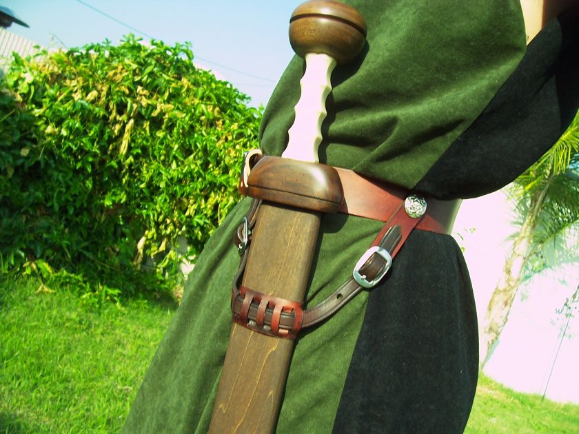

i made my own scabbards! God. i remind me of me!
Hi Gents.
As we all know, swords are expensive and so are their scabbards and belts. But my biggest problem with having a scabbard made is the time it takes....i hate not having my sword around for months.
well im no Christian fletcher or Triton. but i think my work is not to bad. ive made all custom Scabbards for my:
Christian Fletcher Border Watch
ATrim single hander
Albion Armorers
Gladius (still in the making)
Atrim Custom saber.
these scabbards are made from oak and Ceder. some wrapped in thin leather and then dyed. all custom with the blets i desired.
check out these pics of the Gladius Scabbard!
im going to add some roman belt plates and a custom imperial Phoenix for the top of the scabbard.
what do you guys think??

Katie,
Your scabbard looks great. I do have one issue that I should mention:
| Katie Neal wrote: |
| ... these scabbards are made from oak and Ceder .... |
There have been some other discussions about wood for scabbards on the forums here. If I recall correctly, both of these woods are high in tannic acid. This means that you probably should not store your swords in the scabbards, since the steel of the blades won't like the environment.

Crap.
CRAP!!!!!
what would be a better wood to make them out of???

Poplar is supposed to be a good choice.

thanks!
when i make my tinker viking scabbard i shall try and use poplar!
i could allways coat the wood in something. or line it in wool...

Someone suggested varnish... most varnishes will "migrate" acids and other things through them, so such a coating would not likely long prevent the acid from reaching the blade. There might be some sealers available through the museum/restoration industry that would provide a better seal.
However, if the varathane is what I recall (a brand of polyurethane varnish) then it would seal and be more impermeable than standard varnish. But if I recall this material correctly, then you will eventually experience some acid penetration through the coating.
I appreciate the heads-up regarding poplar (now all I have to do is locate some), since I have at least one scabbard on my to-do list.

I have only used poplar, as it was the wood I could remember was safe when I went looking. Home Depot has 1/4"x4"x4' poplar slats that I like very well. Because they are only 1/4" thick, it saves a lot of time in shaping the exterior. I think the boards are about $4 each.
I have not tried this, but you might be able to pour some varnish or boiled linseed oil or something similar into the scabbard and then just dump the excess back out. If there is enough space in the scabbard, I would then wrap the blade in some paper towels (if you use regular scotch tape, they stay put suprisingly well), and use the blade, thus wrapped, to wipe out the remaining bit that you don't want. If the sabbard fits too tight for that, I'm not quite sure what to suggest.
Jean, if the inside of a scabbard has been sealed in some way (such as boiled linseed oil) getting water in there will probably be less of an issue, but I would still take the same steps regardless. When the wood gets wet, it seems to want to relax, thus creating a very loose fit. If the wood has dried out that way, I would get it damp again and use c-clamps or some kind of weight to hold the scabbard mouth closed. Over-correcting is always a problem, but you might be able to use a shim of some kind to avoid that. Today a fan would help speed drying; without that option, I guess just leave it in the sun on a breezey day. Again, I don't have experience with this practice. I'm just piecing together ideas from similar things I have fought with.
