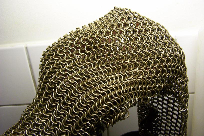

Just wanted to add some of my experiences with giving maille some patine;
This was done on galvanized maille-chausses with butted rings, nothing too serious just decided to experiment making some maille i had laying around look alot better. I put the maille for half an hour in lemonjuice then dry over-night, then 24hours in 80% vinigar 20% water. I then rinsed the stuff in my bathtub, which was dumb, for a few hours then let it airdry. Then i headed out to my backyard and tossed the maille in a plastic bag with sand for a few minutes getting the (cakes of) thick rust off and leaving them brushed and dusty - i then dryed them off with rags and then tossed em around in break-free oil. Now they look great - blackish with a glimmer of brass almost.
Shawn Shaw
Location: Boston, MA USA
Joined: 07 Jan 2006
Posts: 115
PostPosted: Wed 06 Sep, 2006 1:49 pm    Post subject:         Reply with quote
Do you have a picture of the finish on your maille?
W. Schütz
Location: Sweden
Joined: 19 Dec 2005
Posts: 369
PostPosted: Wed 06 Sep, 2006 3:16 pm    Post subject:         Reply with quote
Here are some pics i took in a haste of my maille. Its pitch dark outside so natural lightning wasnt available - i took it in different light-sets for an overall view. I think the first one is most true to life.
 Attachment: 61.76 KB
 Attachment: 98.31 KB
 Attachment: 38.37 KB
 Attachment: 75.74 KB
