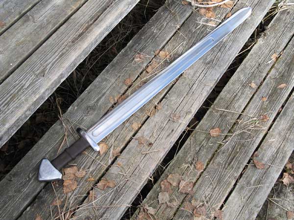

Enter the Joukahainen...
 Attachment: 93.11 KB

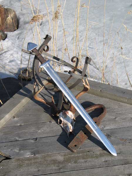

And the last shot.
 Attachment: 67.54 KB

I ground both of them. On the katz I used an old truck spring (correct?) and on the viking sword just some low-to-none carbon steel. That makes the viking basicly a wall-hanger...
The OA lenght of hte katz is about 90cm and it weights something like 1.2kg. Blade width is at the guard about 4cm. PoB lies about 20cm from the guard. The handle is waxed birch with a dark brown wash. The scabbard is made from alder. As with your suggestion about the file work, I agree. There could be some. I was going to twist the bar and then shape it to S but finaly decided leave it plain. Thats because the pommel. It has straight lines and no decoration. I wanted to give the katz a mean no-nonsense appearance.
The OA leght of the viking is about 94cm with a weight of 1.4kg. It has PoB about 25cm from the guard. The handle has an ash core with a thick leather riser glued on and covered with thin leather. I'm currently working on the scabbard and I quess it will be complete later today.
I make swords for my own pleasure. I made my first four years ago when I saw the FotR and fell in love with Arwen's sword. Since then I've made another elven sword, Gimli's walking axe x 2, a Zatoichi-like kane sword, a Spatha, a warhammer from a railroad spike and these two. I also make puukko-knives wich is a dear hobby along with swords. Once I even dreamed of making a profession out of them but decided that I enjoy it more when I don't _have_ to make them. I'm graduating within a month from Kuopio Academy of Design, Finland. That means that I don't have workshop anymore... I quess I have to build my own one day =)

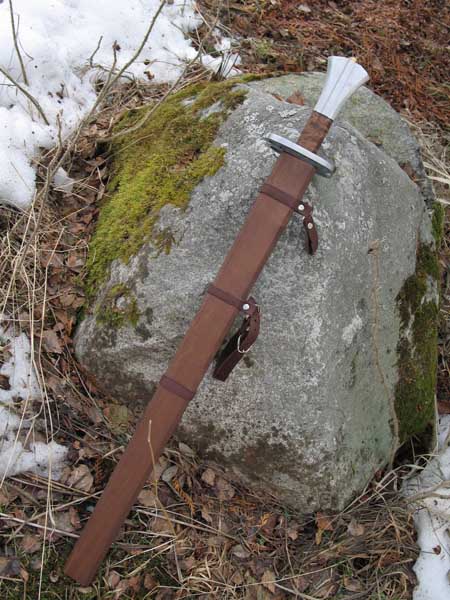

I just finished the scabbard for the viking. I think it turned out quite nice. Now I'll just have to figure out how to attach it to a belt or baldric... I'll post some pics as soon as I can.

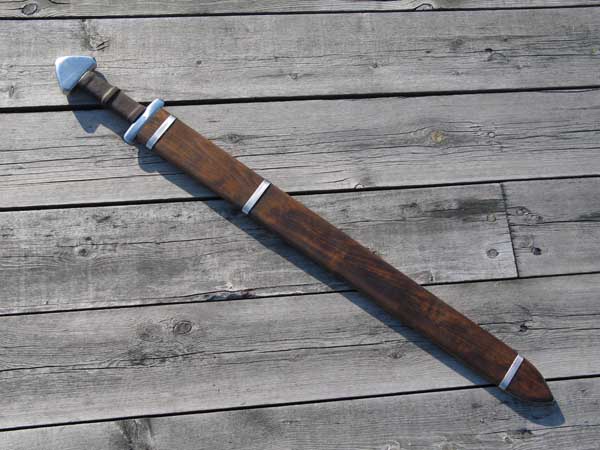

Mikko Remes
Location: Finland
Joined: 04 Apr 2006
Posts: 23
PostPosted: Thu 27 Apr, 2006 11:43 pm    Post subject:         Reply with quote

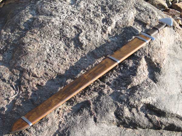

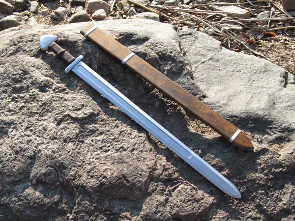

And here's the scabbard. It was made from alder with sheet-metal 'rings'. I gave it a dark brown wash and later I treated it with "Danish Oil". Great stuff. Works fine for knife handels, also.
Thanks for the link. That's something I had in mind too. In smaler scale, though.
-mr
 Attachment: 105.23 KB
 Attachment: 63.4 KB
 Attachment: 102.51 KB
Hakkaa päälle!

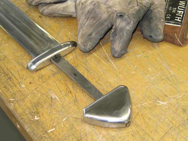

PostPosted: Fri 28 Apr, 2006 11:46 am    Post subject:         Reply with quote
Shawn Shaw wrote:
How did you assemble your guards? Any chance of some close up pics?
The guard was made from a 16mmx16mm square bar. The opening for the tang was then machined to it. I filed the hole to a tight fit. After I was happy with the fit I ground the guard to a shape with a belt sander and polished it. The pommel was made from 20mm thick steel. I used an angle grinder to saw off the rough shape. Next I drilled a hole for the tang and machined it roughly to fit the tang. After I got the grip fitted I peened the tang to secure the grip and pommel. It came out pretty good. No rattle nor movement what so ever.
-mr
 Attachment: 51.89 KB
