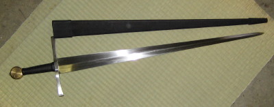

This XV is heading east, for review...........
The AT1401, the first of a new series.........
 Attachment: 21.71 KB

Mymymy this does look good ! From the picture it looks fairly thick with a deep hollow grind in the forte at least !
The hollow grinding maybe becoming flatter as the blade narrows ?
Don't have any ATs " yet " but I'm looking forward to seeing more of this series.
And it doesn't hurt that the prices of ATs are more mid range in price while the product from what I have read are closer to the high end in performance.

I don't think it's hollow-ground. That isn't something Gus has done in the past. If he's doing it here, that's something I'd hope he'd be pushing really hard because it would be new stuff!
PostPosted: Wed 05 Apr, 2006 7:28 pm    Post subject:         Reply with quote
You could be right, and it might just be the lighting, but if I had to place a bet on it I would put more money on it being hollow ground just by the pattern of the reflections.
Maybe we will know soon if it is hollow ground ? I think I read something about Gus starting to work with hollow grinding on a post of his on another forum. ( If my memory serves me right. )
The ridge / spine just looks too defined or thick for a flat ground blade. Wink
In any case it still look vey tempting: Oh, no DOOMED again to a smaller bank balance. Razz Worried Big Grin

Gus has indeed attempted his first hollow ground blade, though I don't think this one is it. I believe this sword is part of a new series of thick (.36"?) type XV's he's working on. There's some more info and a link here: http://forums.swordforum.com/showthread.php?s=&threadid=64833. Happy

I've gotta agree with you, Jean. Whether or not it is hollow-ground, I have no way to know for sure (hopefully Gus will enlighten us soon Big Grin ) but based on that picture, my money says that it is. Especially down near the gaurd it looks like it is hollow-ground. That would be pretty cool, good to see Mr. Trim is taking things to yet another level! So many options...Nice work.

Nathan's right, this particular piece is not hollow ground. The ridge did come out kind of pronounced though, but I think that's because of the included angle of the main bevels there. The sword blade is 29 inches, its two inches wide at the base, and it .35 inch thick at the base. Plenty of distal taper, but the point is very strong....... Handling it, its definitely a thrusting sword, but still, I was able to cut a water filled 2L bottle with it, and take the second ring too....... Still, its a thrusting sword, that can cut a little.......
You're right, in that I have a blade in heat treat, that has the "hollow ground" main bevels. Its an XVIII though, a lightweight sword........
Nathan pointed out what I do on a thread on sabers..... I start something to get my "head wrapped around it", and travel from there. I understand what some of the hollow ground geometries should look like, but before getting into some of the more challenging sword types, I like to experience things simply.......It looks good enough that I started a couple of bastard sword blades too...........but I'm not going any further with it, until I get a couple of these first ones done..................
This XV however, is also the first of a series. At 2lbs 13, its no lightweight for a blade that long, but then again, its intended as a "battlefield sidearm", so it should be able to hold up to some armor pops {and it will}........ The next size, XVa, blade 35 inches, handle, 8 or 9, stiffer than the "little stiffy".........
