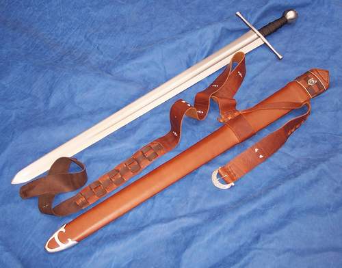

Just received my scabbard for my Albion Tritonia that I ordered from Russ Ellis and it looks real good.
Russ made it using his own Tritonia to get the fit for the scabbard: I could have opted to have the Tritonia sent to Russ directly for him from Albion to make the scabbard but I guess I wanted my Tritonia in my hand as soon as possible. ;)
This was a risk, but a small risk as Albion is very consistent in the dimensions of it's swords: I would think twice about it with another brand that may have more variation from sword to sword of the same model.
The good news is that the fit is perfect. :D :D :D
The whole ordering / designing process was very enjoyable and efficient. All my E-Mails were promptly replied to.
After a bit of back and forth where I suggested a theme, the Wolf, I just let Russ do his thing un-micromanaged and he did a great job. The whole process from first contact to finish was about 7 weeks.

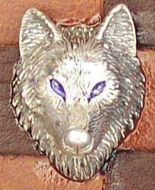

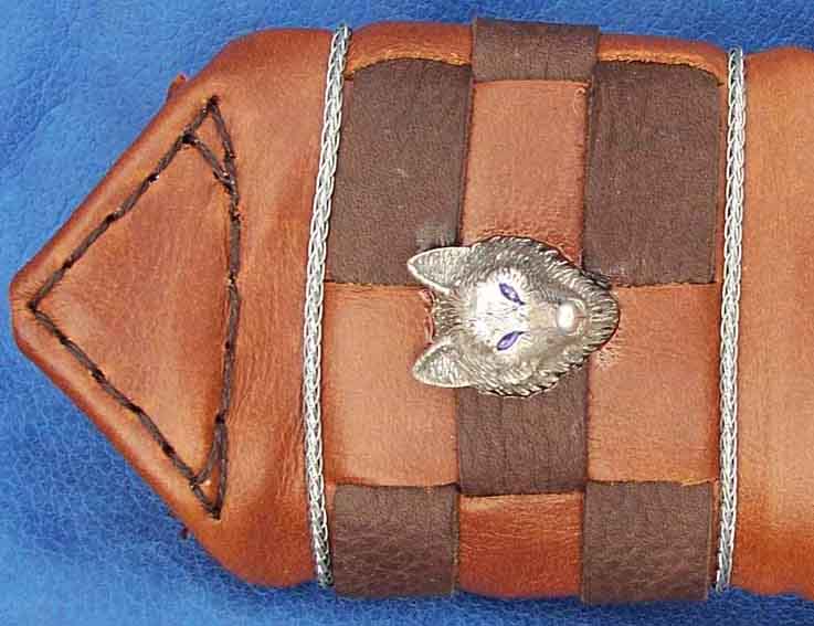

The main Wolf metal decoration is much more 3D than what the Picts suggest and looks real good. There are also some tiny wolves heads accents on the belt.
I do have other scabbards that are just meant for storage mostly and one from Albion for my Sovereign that is nice but just a campaign scabbard: This is my first custom scabbard and it is a shame that scabbards are often seen as money that could have been better spent on another sword, because a good and attractive scabbard enhances the look of the sword and is part of the whole package.
Russ supplied me with some Picts as I don't have a digital camera yet so that is why there are no shots of the sword in scabbard. :p :lol:

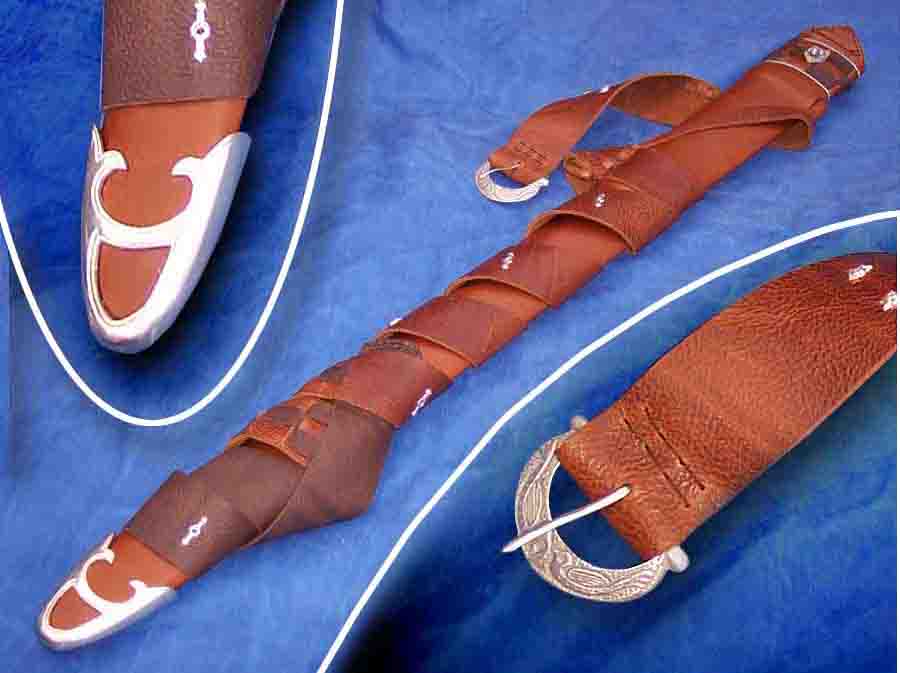

Thanks Kenton, Edward, If Jean doesn't post them, I'll put up some pictures of the scabbard where you can see the suspension a little better later. The suspension is not one that I've seen on any other modern scabbards (although someone may have done it somewhere) but one that I copied from a couple of brasses and an effigy. More on that later....

Just supplemental about the fit of the scabbard.
The fit is snug but in no way tight: No forcing needed to seat the blade in and not much more than a light tug to pull the sword out. If held upside down the sword stays in the scabbard and only falls out with a sharp but not excessive up and down shake and sudden stop.

I'm going to have to repeat my comment from a previous post:
Aaaah, it's so cute!

Yeah, cute. :( I was going for scary :evil: ............ :cool:
The lighting on it is a bit too frontal, a bit of side lighting would bring out the 3D ness of it better: A full 3D head not a low relief by the way.

Okay here are a couple of more pictures. I found this particular suspension system a bit more interesting to do. It was influenced by several sources. The most prominent is the brass of Sir Roger de Trumpington, Trumpington Cambs, c 1326. Also the brass of Sir Robert de Bures, Church of all Saints, Acton Suffolk circa 1331. A simialar scabbard is also found on the effigy of Sir William FitzRalf, Pebmarsh, Essex c 1335. Having said that I have to admit that the suspension is my interpretation. That's really a huge problem when looking at pictures of effigies and brasses... that is what is on the back side of the scabbard? In this case I did what I could see on the front side and then used what I hope was a logical process and a little experience to come up with a good solution for what the "hidden" parts of the suspension would look like. I can't say for sure that the hidden part matches what the original would have been like, however it does provide a secure suspension and I believe it is probably correct.

Is that Tritonia rig left-handed or are my eyes going bad?

Great Picts: Hmmmmmmm ...... This gives me and idea what to do with the belt after it is bucked. Pass it behind the scabbard to the other side of the sword / scabbard before pushing it behind the belt. As the belt is very long to accommodate wearing over armour it is very very long just over a gambison: Worn this way a lot of the extra length is taken up going to the other side and avoids having the end of the belt close to near your ankles if just left to dangle from the buckle. :lol: ( Exaggerating a bit. :p )

That's very nice :D
I had a simalar idea but with a boar instead of a wolf. The braided wire is an excellent touch.

Thanks for posting the pictures Chad, and yes you are correct this thing is left handed. I VERY nearly built it as a right handed rig. Fortunately I went back and checked my worklist one more time before getting started on the suspension. It would have been a gigantic pain to have to redo it.
Jean, absolutely, I'm sorry I should have mentioned that to you. Having all that extra belt strap was by design as per the pictures posted above.
