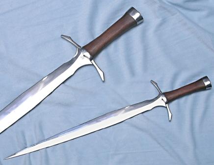

I have seen a lot of fantasy type swords that feature a leaf type blade (note especially "Sting" from the Lord of the Rings). While I thought at first that this style of sword was completely fictional, I saw some swords on Christian Fletcher's website, based on some Angus Trim models, that feature this leaf style blade and seem to be legitimate and functional. Also, the website mentions that the leaf-blade was used by the Greek, Romans and Phillipinos. Does anyone know anything about this? I'd love to hear your comments. I particularly like the leaf-blades, I think they look great, but I also want a sword that is functional, that would work well in a battle situation. Anyone know anything about leaf-blades and their historicity and functionality?
I attached three of these Fletcher swords.
 Attachment: 10.13 KB
 Attachment: 8.21 KB
 Attachment: 8.68 KB

To add: Jared, all the swords you are showing in your post are of "contemporary" (fantasy) design.
