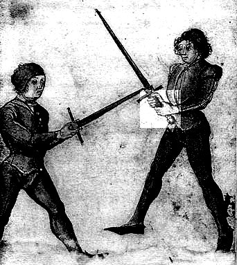

There are a few pretty enticing clues for believing in longswords with long grips during the 14th century.
Liechtenauer taught in the mid 1300's (born around 1320?) He based his version on international travel study of techniques already developed and practiced by other experts. Students actually wrote many texts about his style of swordsmanship, so it is credible that they modified or changed his original opinion of sword grip over a few decades after he died.
Whatever the case, that school recommended a sword long enough for the pommel to reach the arm pit, and a grip with enough room to place both hands on with a definate gap in between (some interpret this as both hands on the grip without covering the pommel so that pommel strikes can quickly be done with no injury to the hand.) Artwork from a wide variety of sources and time periods is very consistent with the image this gives.
However, surviving specimens datable to this era are very rare. Not non-existant though.
I have theorized (have zero credentials or authority to assert this, but remain very interested in the answer) that rarity of surving specimens could be due to a variety of reasons;
Actual use may have been primarily for training and unarmored dueling in the early 14th century. It was described as a "foundation" weapon and technique for training with both polearms and other types of swords.
IMHO cavalry would have preferred hand and a half grips. Long grip swords may have been used more by mercenaries on foot, and perished in battle.
Blade damage and poor survival rate may apply to these types of swords. Speed and force possible with this type of grip increases. Lancelot Chan's video of obvious damage/tip deformation (Albion Brescia Spadona) resulting from hitting a pig leg resting on a cardboard box using only mild sparring strokes is something people should see if they have not already. This is not a particularly long grip length (8"? ) sword, but it is pretty obvious what its design can do, and what toll is taken on the tip after gentle use.
Jared, I think you misread the topic. "IV", not "XIV". Wink It's okay, I misread it too at first, but when reading the posts I got confused and looked back only to discover my mistake. Happy
Sorry for getting off topic here, but are you sure? I've never read such a measurement in the Liechtenauer school, though Vadi gives this measurement (he's Italian). Also, not all masters had a definate gap between the hands. Doebringer in particular said not to grip the pommel but to instead have both hands on the grip itself (and considering that so many longswords didn't have that much space on the grip, some swords would require having the hands together). And here's an image from the Solthurner fechtbuch that shows the hands close together (the same manuscript also shows the hands apart as well).
Sorry for the off-topic diversion everyone. Happy

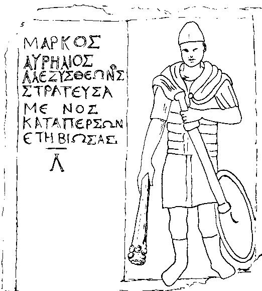

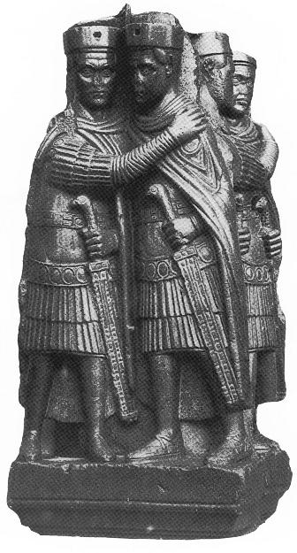

After looking through the first things that were at hand I found two examples of long gripped spathae illustrated in Osprey´s Warrior series: "#9. Late Roman Infantry man AD 236-565" and "#72. Imperial Roman Legionary AD 161-284"
In the first is printed a photo of the famous relief in Venice of Emperor Diocletian (AD 284-305) with his coemperors. All four guys have the same long gripped spathae with eagle head pommels (I´ve always wondered about those strange swords: never knew of any similar weapons from anywhere else).
Interestingly, you can make out long panels at the top of the scabbards that remind strongly of the garnet decorated panel at the top of the scabbard of the sword that is the focus of this thread...
I would also say that the size and proportions of Diocletian´s sword is spot on!
The second picture is a drawing made by Steven D P Richardson of a gravestone of a legionary from Sparta who served in Caracalla´s Spartan cohort AD 212-217. The gravestone is in the National Archaeological Museum in Athens.
Not much detail can be made out of the sword other than general size and proportions: very close to the archaeological find.
It is interesting to note that we have here a third version of hilt type: kidney shaped pommel, much like that on a regular short gripped spatha and a stubby guard. Apart from the long grip, it looks rather like the run of the mill spatha hilt.
Diocletian came from Illyria, corresponding to former Yogoslavia, while the legionary came from Sparta...
Do we have an eastern europe/balkan origin here?
This is all new to me. I would like to learn more!
Any input is much appreciated!
