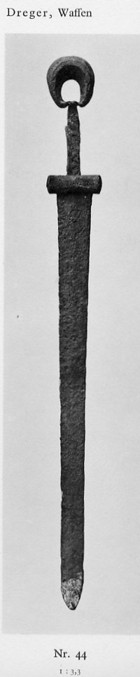

Posted: Thu 15 Sep, 2005 2:44 am Post subject: |
Hi
I was just browsing through "Waffensammlung Dreger" when I saw this ring sword and remember this thread. I have included a scan of the text (If any german speaking forumites can help translate?) descriptioin as well.
Søren
Attachment: 106.49 KB
Attachment: 23.3 KB
