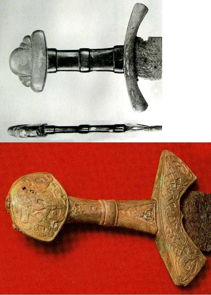

Not too many Viking swords with grips remaining. However of the grips remaining quite a few have an hour glass like shape. They are not as symmetrical as those of the Migration Era... The Viking grips have a slight waist in the middle but the upper part of the grip is usually smaller than the lower part. In this sense they are almost transitional between the hour-glass hilts of Behmer's Type 3 and the later Knightly sword grips.
Here are a few pictures of what I have.
ks
 Attachment: 63.59 KB
 Attachment: 76.03 KB
Suontaka pic from Vikings: North Atlantic Saga. River Scheldt sword from Oakeshott's "Archeology of Weapons" [ Download ]
