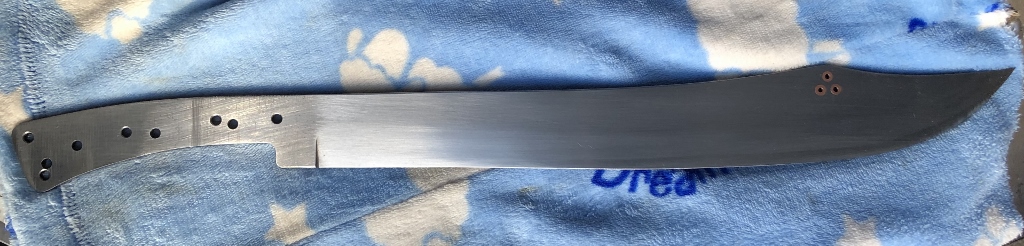

I chose a machete of about 15" blade length and 5/32" thickness (see attached "before" picture, taken after I knocked off the plain wood handle scales).

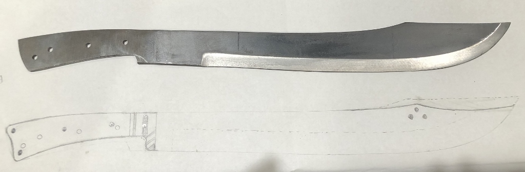

The "after" picture shows the blade after major reshaping. A lot of work with my small 1" tabletop belt grinder, and finalizing the shape by manual sanding to 150 grit.
Most obvious changes are in the handle (narrowed down and more "bauernwehr-like" in style, new pin holes and nagel hole drilled); point (gave it a clip point and three decorative copper lined holes at the cusp where the blade is widest), and edge grind (extended the edge down close to the future bolsters, reground all length of blade at more acute angle and then rounded off the ridge to make it look more like typical flat ground bauernwehr).
Feels like most of the blade is of spring hardness, but the edge is much harder (for about 1/4" along the edge). They must have applied some kind of differential heat treatment.
Overall, it feels like it should be a fearsome chopper when completed! And with a useable point, too. Just what I imagine a serious bauernwehr should be.

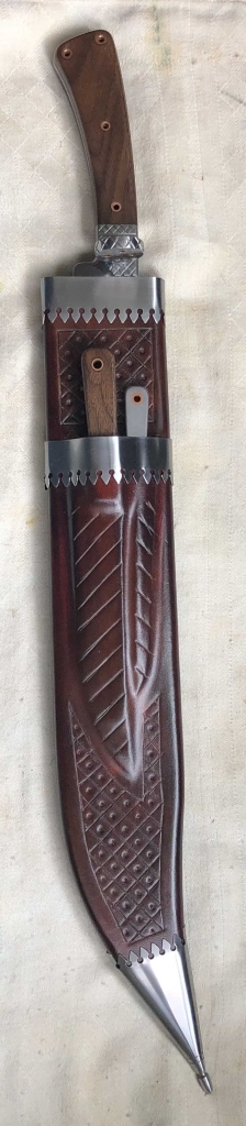

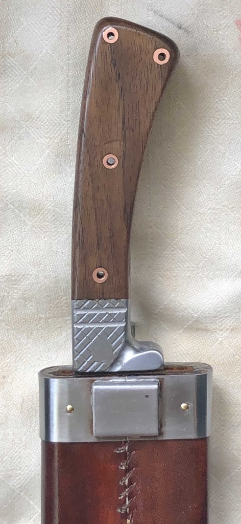

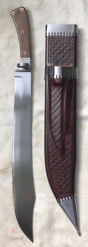

PostPosted: Sun 08 Oct, 2023 10:47 pm    Post subject: Project finished!         Reply with quote
Finally, this project is finished!
I went for steel and copper pins look for all pieces, plus walnut for handles.
By-knife is finished in more or less same style as the bauernwehr, and the pricker is all steel.
Scabbard has leather covered wood core and mild steel fittings. Back of the throat has a loop for a narrow belt.
 Attachment: 178.09 KB
 Attachment: 276.18 KB
 Attachment: 375.78 KB

PostPosted: Sun 08 Oct, 2023 10:53 pm    Post subject:         Reply with quote
more pictures, from the back and side
 Attachment: 119.21 KB
 Attachment: 104.05 KB
 Attachment: 149 KB
