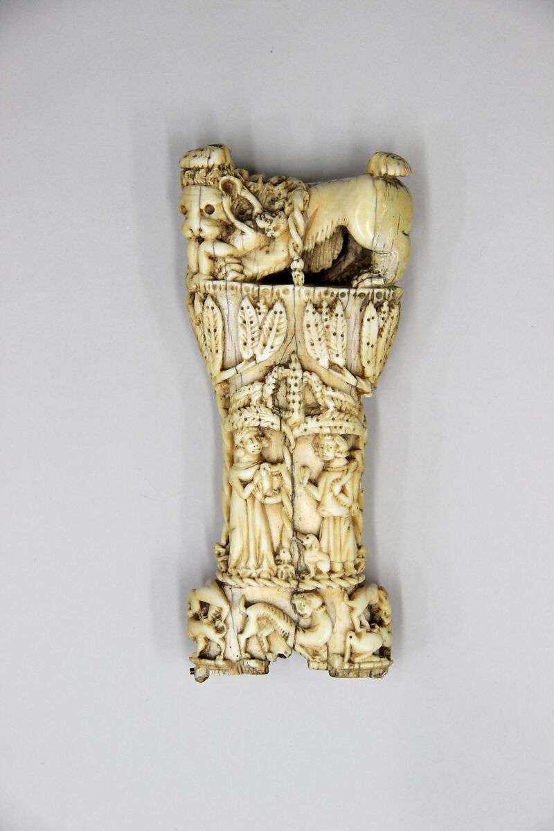

I've done a bit of searching around in collections and have found a few pieces that could add to this discussion. First, here are a few Italian ivory hilts from the MET museum that are quite lovely. When I saw the dagger carried by Acciaiuoli I immediately thought that it looks like the type of thing carved of ivory. Not that it couldn't be wood, or something else, but I think the shapes and contour in that hilt lend itself to a material like Ivory more. These three are nothing like the Acciaiuoli hilt, but two date from the right period and show what period bling could be.
https://www.metmuseum.org/art/collection/search/27624?ft=49.57.3&offset=0&rpp=40&pos=1
https://www.metmuseum.org/art/collection/search/34077?ft=29.158.658a&offset=0&rpp=40&pos=1
https://www.metmuseum.org/art/collection/search/21961?ft=04.3.141&offset=0&rpp=40&pos=1

Ryan, thank you for the great context and history. Really cool to know that this story has some historical background and what it could be. I never imagined that there was any real history behind the play until this thread!
