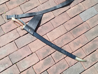

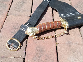

Dixie Gun Works 1742 British infantry sword, rehilted in the style of William Moulton or John Bailey (albeit with cheaper materials: maple grip, brass hardware). As usual, full details are on my blog.
The grip and ferrule on this come from a GAoP cuttoe which I still haven't actually made, before I rethought the design and decided against what I already had. If I'd had more research done back when I made the grip, I'd have finished it with shellac and oil-rosin varnish instead of just oil. The other thing I'd like to change (and still might) is the stitching on the belt, so those big ugly knots aren't on the outside.

I'd say a job well done Dan. The grip contour is quite good but might have been better done in bone. I can't recall any I've seen in bound wire but I have seen shagreen and ray skin. Another thing I would look for is silver or copper tape instead of twisted wire.

Thanks. I agree bone would've been preferable from a historical perspective... I just hate working with it, and the wood one was lying around waiting to be used.
By tape do you mean a flattened wire, like on this one? Have to admit it didn't occur to me to look, but it would probably make the grip more comfortable -- the round wire is a little too prominent.

Yes, or even thinner material. I have a sword grip of the time with a little of everything wire wise and the tape is plated copper.
The wood look nice. Later on, we see cherry used some for sword grips.

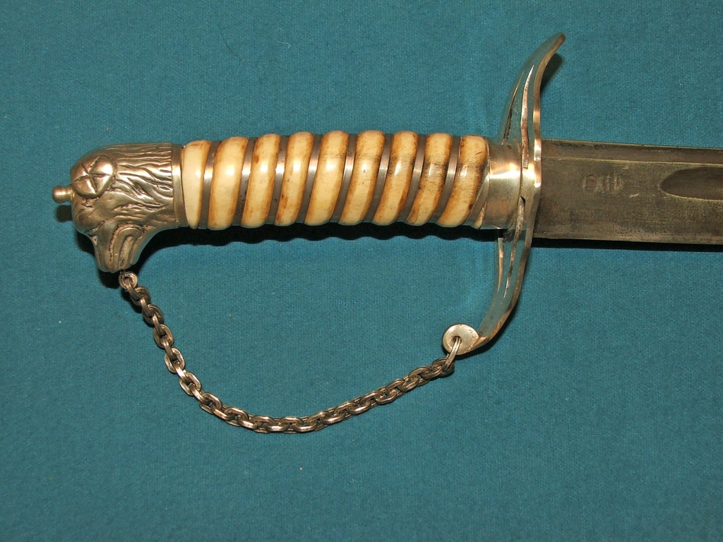

And another that looks similar to yours in its mountings, though these are silver. The grip is ivory, and the accent (as Mr. Cleeton mentioned) is silver tape rather than twisted wire.

Thanks for those.
If I've got a good handle on the subject and the antiques dealers can be trusted (both rather large things to assume, I know) then the first one is a similar time period, but has more of a continental European look, perhaps French. It is interesting, if true, that the Colonies developed their own style at this time.
I might replace the wire with tape, but the hilt's held together with pitch as well as a nut, so it'll require heating it all the way through -- probably by leaving the whole sword in a low oven for a long time.

Help help, I'm running into trouble with this. Some corrosive material has gotten into the scabbard and caused several spots of active rusting on the blade. I suspect loose fibers of the vinegaroon-stained belt, even though I tried hard to neutralize the leather with baking soda, and wash and dry it thoroughly prior to oiling.
I've polished the rust off and am keeping the sword out of the scabbard for the time being. Is there any way to fix this situation other than making a whole new scabbard and belt?
