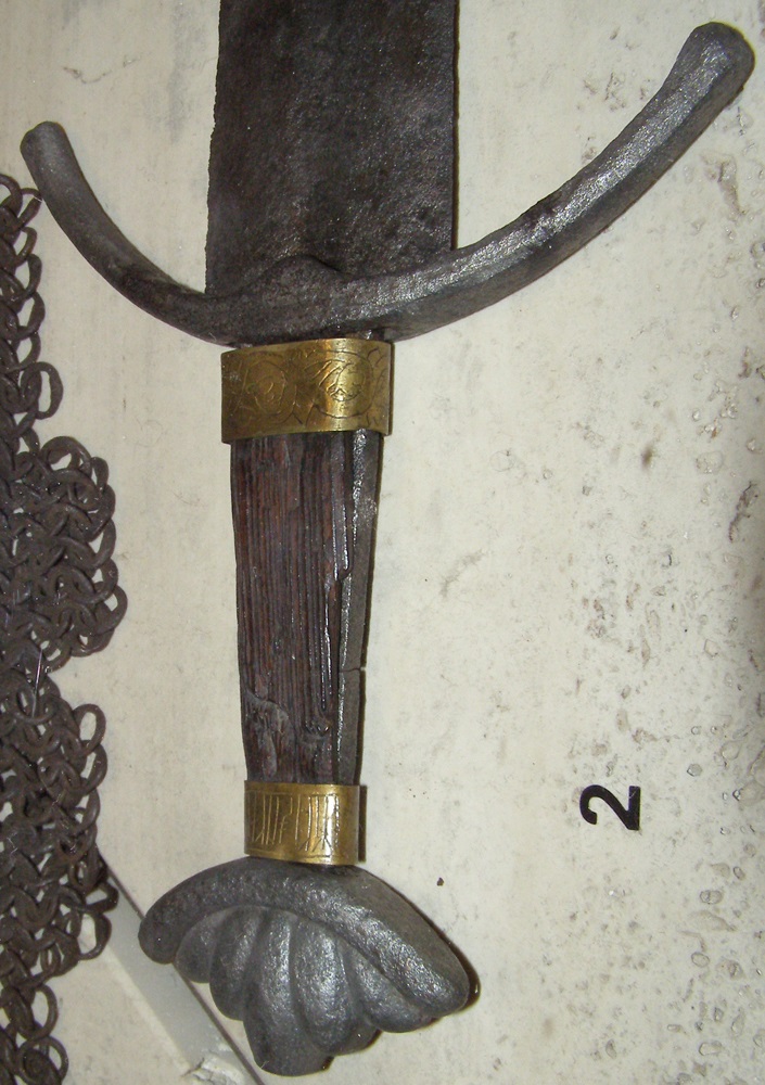

To my mind "A" and "E" look correct, as they seem to my eye to match the curvature of the upper and lower guards. But the other three could be in any order, I suppose.
I should point out that the more wasp waisted type hilts seem to be more of a Migration Period thing, particularly with some of the Danish Bog Finds.
The only parallel I can find, though it dates from the Late Viking Age, is the sword from Korsødegården, Norway. Note that some organic elements of the grip survive, and it shows a steady taper from the cross to the pommel (see photo).
