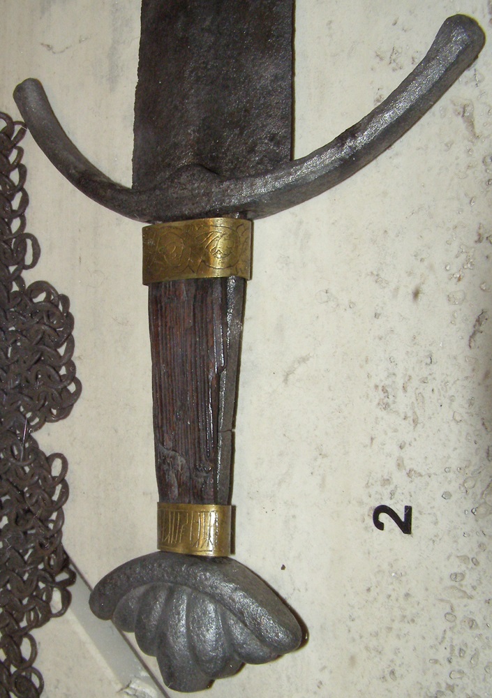

To my mind "A" and "E" look correct, as they seem to my eye to match the curvature of the upper and lower guards. But the other three could be in any order, I suppose.
I should point out that the more wasp waisted type hilts seem to be more of a Migration Period thing, particularly with some of the Danish Bog Finds.
The only parallel I can find, though it dates from the Late Viking Age, is the sword from Korsødegården, Norway. Note that some organic elements of the grip survive, and it shows a steady taper from the cross to the pommel (see photo).

I do kinda get the impression that bands C and D might have swapped places... but that would only make the taper more even.
There are several Viking Age swords with enough remaining of the wooden grip or metallic grip ornaments to clearly indicate a tapered or cigar-shaped grip, for example pages 95 and 140-141 in Ian Pierce's Swords of the Viking Age, although the asymmetrically waisted shape - of which there's a beautiful example on page 44-45 - does seem to be much more common on surviving specimens.
