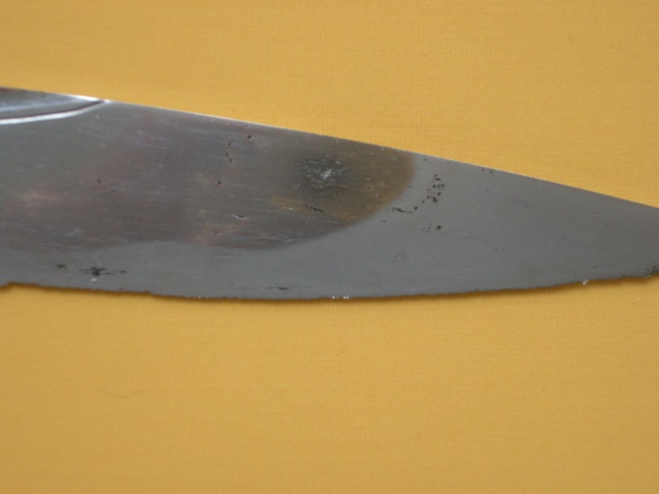

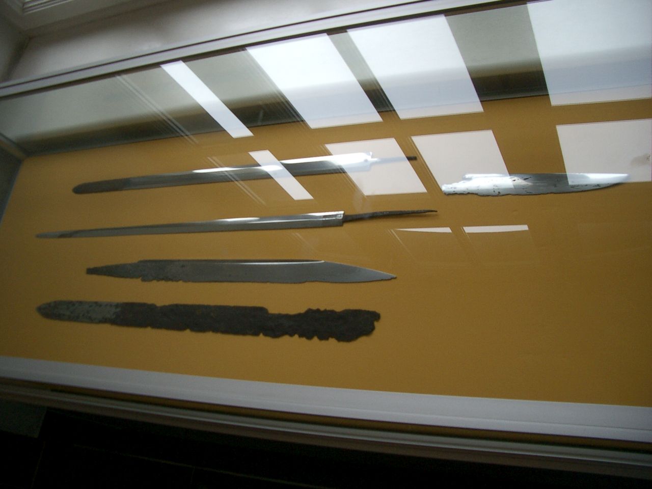

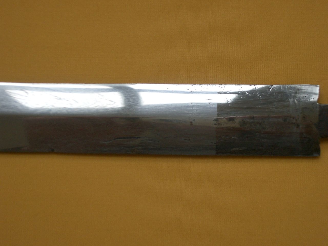

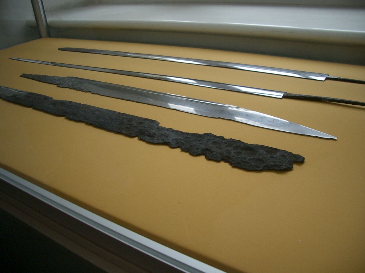

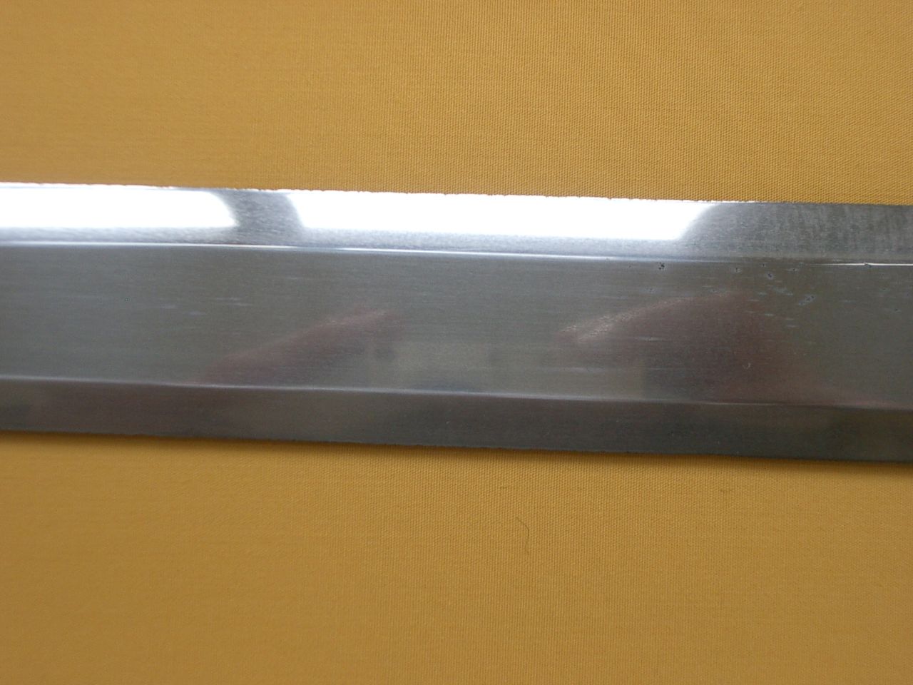

In the Klingenmuseum in Solingen they have a couple of swords, which were polished by a Japanese trained sword polisher. The sax has a very nice and visible hamon. All these blades seem to be in perfectly usable condition.
