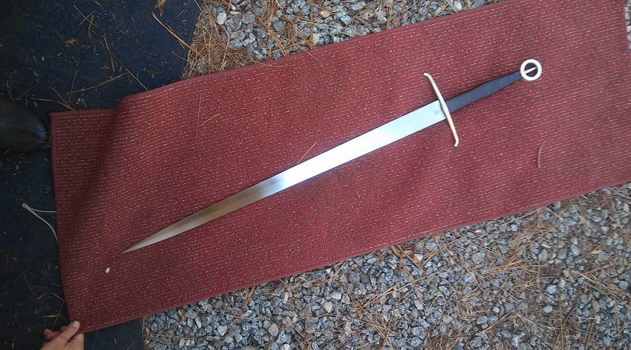

Inspired by pics of two previous 'Irish ring-pommel' swords they've made (see attached pics).

Some material progress on my sword commission. The maker has been busy throughout holiday season, and eventing down in Florida (start of Ren faire season down there) - which they've kept me apprised of throughout.
The profile is looking nice. From most recent email with progress pics:
"Attached are the rough grind blade shape. She's 1.9 wide at the base so far, and I'll doing the distal taper and finishing grinds on her this weekend and we'll see where the weight ends up. I may narrow her more but we'll see."
- which is all within my requested parameters. We're aiming for a target weight of 2.5 to 3 lbs., so we've gone back and forth about blade width, stiffness, etc.

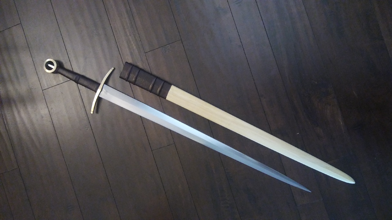

Posted: Wed 29 Jul, 2020 8:36 am Post subject: |
Quick, belated update. Been super busy adapting life (like all of you I'm sure).
I got my commissioned sword from Sterling Armory back in March (I think?).
It's freaking awesome, and am completely pleased with the finished product, and the whole process.
Attachment: 232.81 KB
Faugh a ballagh!
Randall Moffett
Posted: Thu 30 Jul, 2020 3:43 am Post subject: |
That is a wonderful looking sword. It looks very serviceable as well. I am glad it turned out so well and you are enjoying it. Thanks for sharing.
