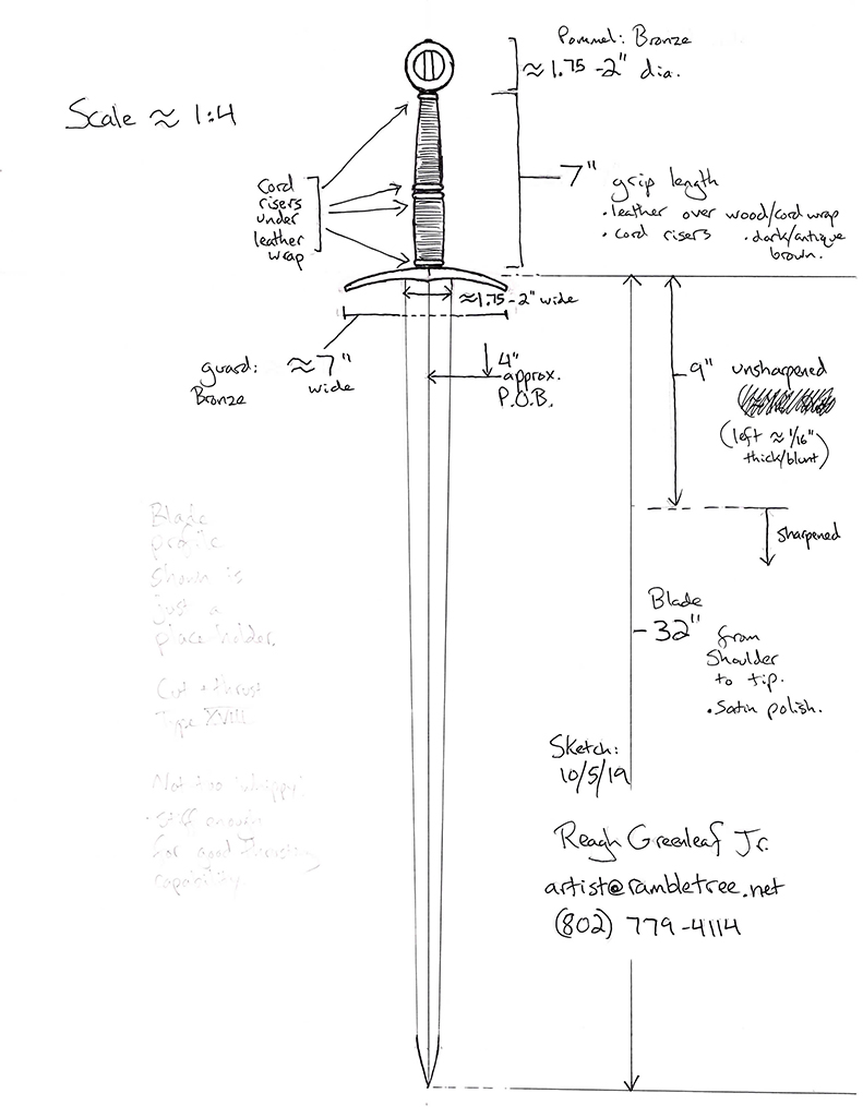

Design (see sketch): Quasi-historical Irish 'ring-pommel' bastard sword.
General parameters:
OAL: 41-42"
Blade length: 32" from shoulder to tip.
Going for an Oakeshott type XVIII(a) style blade.
Bronze pommel and guard.
Grip: Leather over wood core w/cord risers, pressed with cord wrap.
Blade steel: 5160, treatment, hardness, geometry, etc. similar to Atrim or Tinker swords.
Suitable stiffness for it's type (not 'whippy').
Peened construction.
Note: Chris estimated a weight of 2.75-3 lbs. for these parameters.

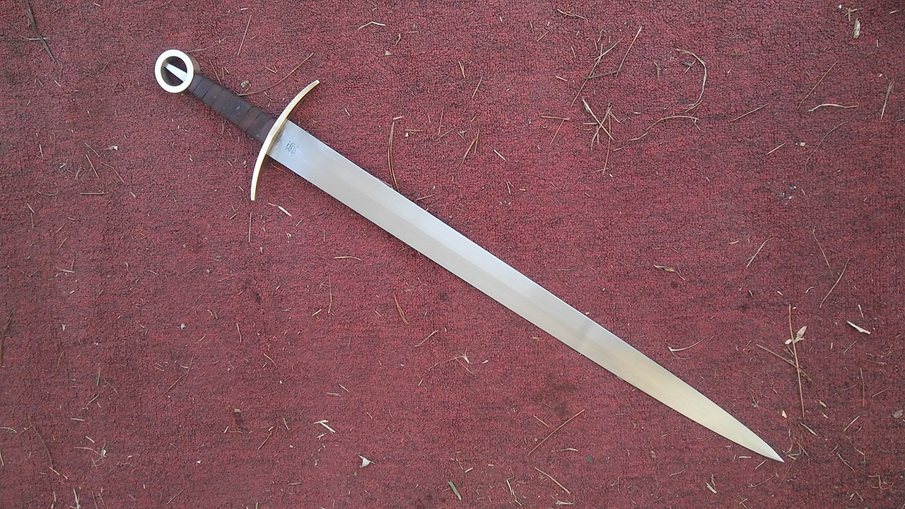

Inspired by pics of two previous 'Irish ring-pommel' swords they've made (see attached pics).
More of a Ren-Faire piece than any kind of actual HEMA configuration.
I'd call it 'historically-plausible'; shameless Irish/Celtic self-gratification.
Short-in-the-blade for a long sword, and long-in-the-grip for an arming sword. Not very wide cross guard.
I'm certainly biased towards 'katana-like' proportions from my Korean/Japanese martial arts background.
