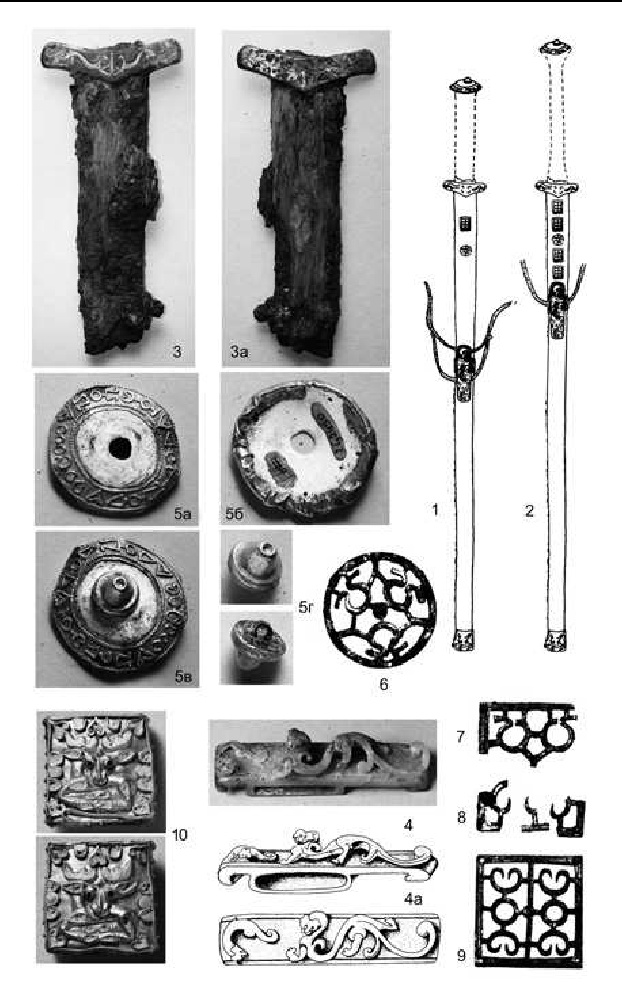

Look at Long Sword and Scabbard Slide in Asia by Trousdale, lots of info there.
Blades can have either lenticular or rhomboidal sections. Many examples show extensive cloisonné decoration, while simpler examples sometimes have organic guards. The pommel in at least one example shown in Trousdale's book is very simply attached to the wooden grip with a single copper nail, not a very robust construction at all. I hope this helps a bit. I have quite a few pics of examples of this type of sword on a thumb drive somewhere. I have not been able to find it yet, but I'll keep looking.
I found 1 pic of cloisonne example from Crimea I believe.
 Attachment: 66.07 KB
Thanks.
I looked through the book, but I don't think it has enough details of what I need.
Images would be great, don't worry if you can't find them though. Happy

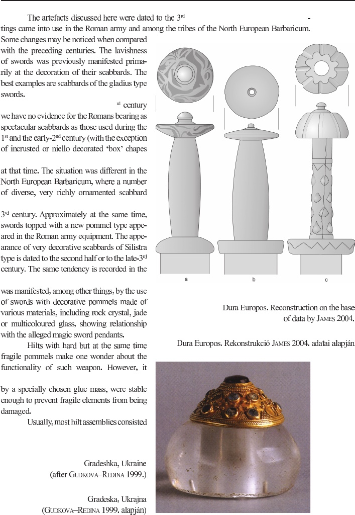

PostPosted: Mon 18 Feb, 2019 5:13 am    Post subject:         Reply with quote

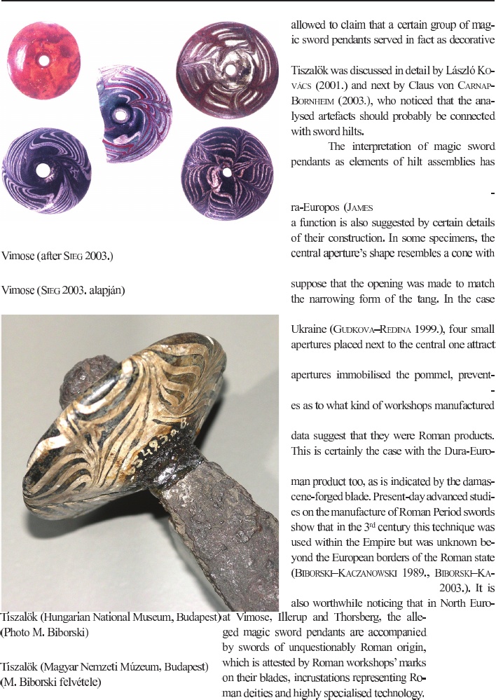

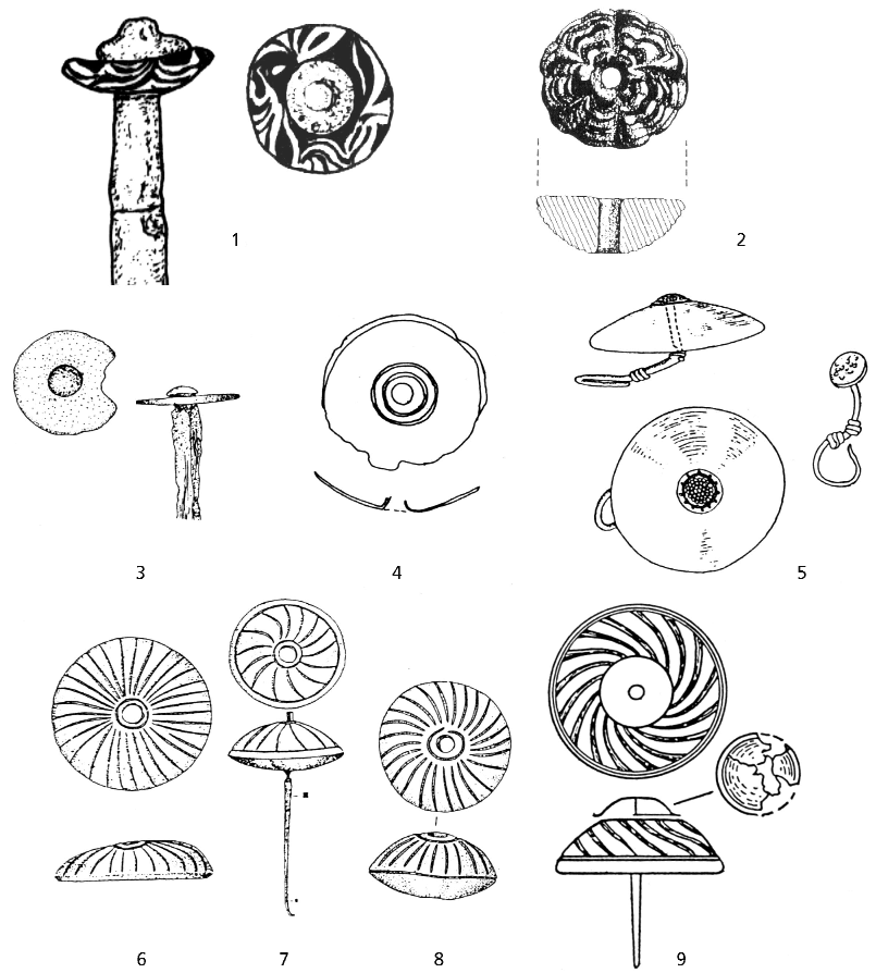

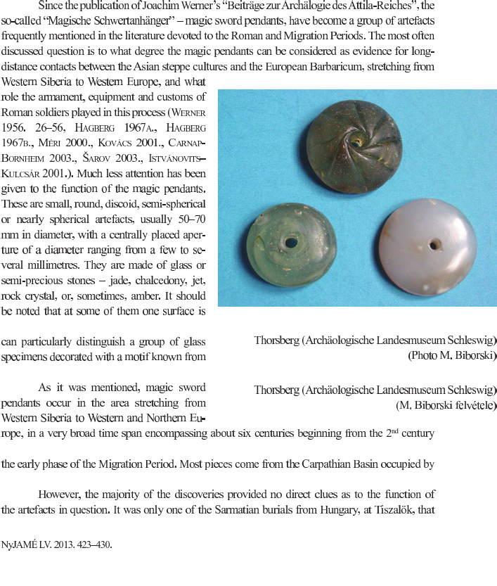

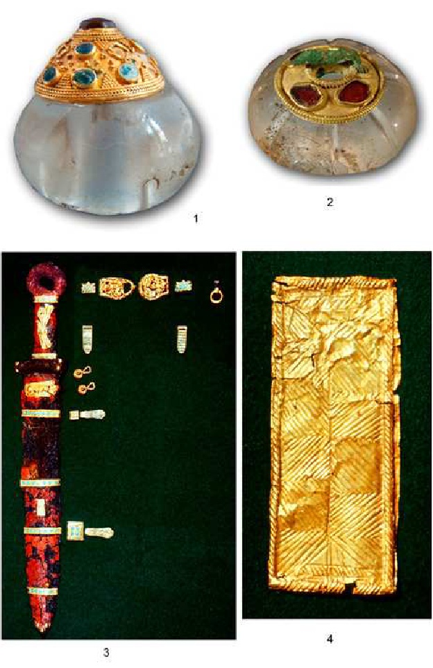

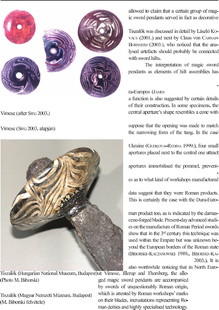

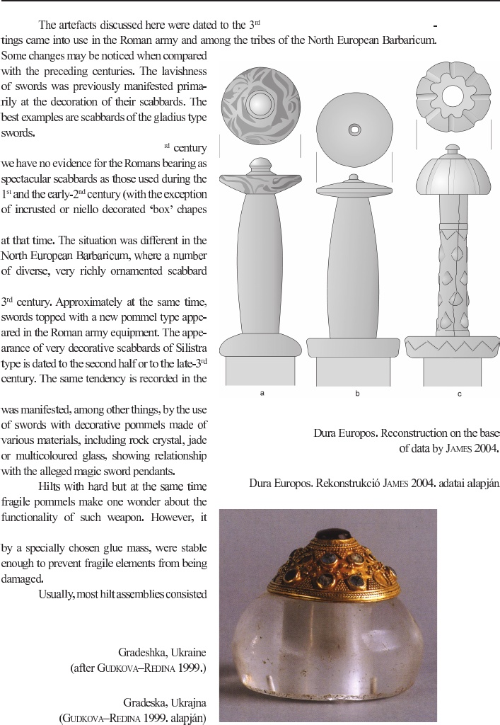

I found a few more pics.
 Attachment: 395.17 KB
 Attachment: 300.41 KB
 Attachment: 248.88 KB
 Attachment: 205.77 KB
 Attachment: 202.04 KB
 Attachment: 132.96 KB
Thank you, great stuff!

I could not find the overall pics of the Stara Zagora swords, though closeups of furniture and a line drawing are shown in one of the pics above. I am glad you brought this topic up. Years ago I was planning on reconstructing one of these and put a lot of time into making a stone pommel. Now maybe I will finally get around to finishing one. Keep checking this topic, I'll add pics as I find them. Are you only interested in the long-bladed long-gripped versions? There are short sword versions too.
