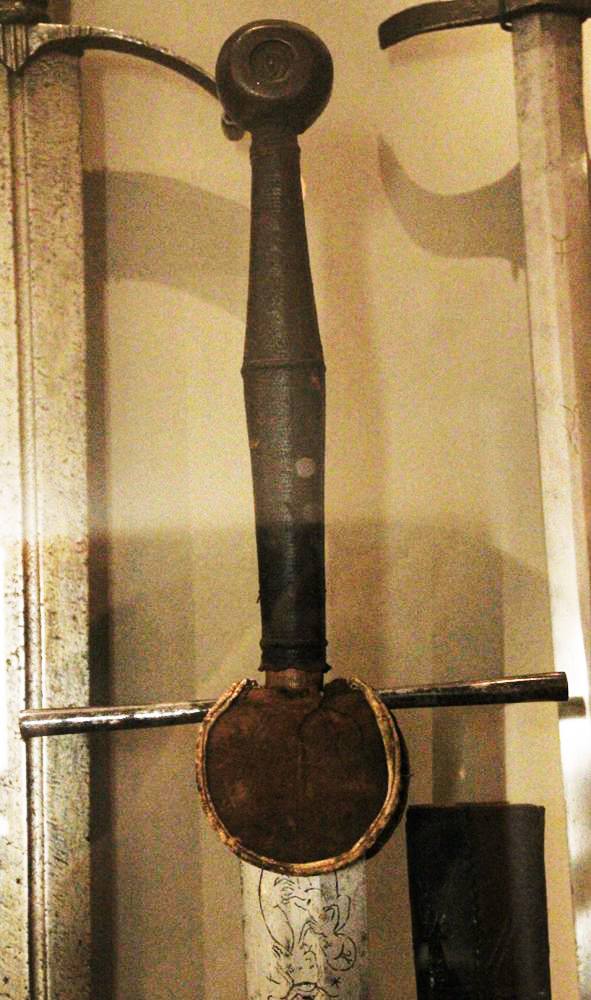

This is one of my reference images.
 Attachment: 84.09 KB
