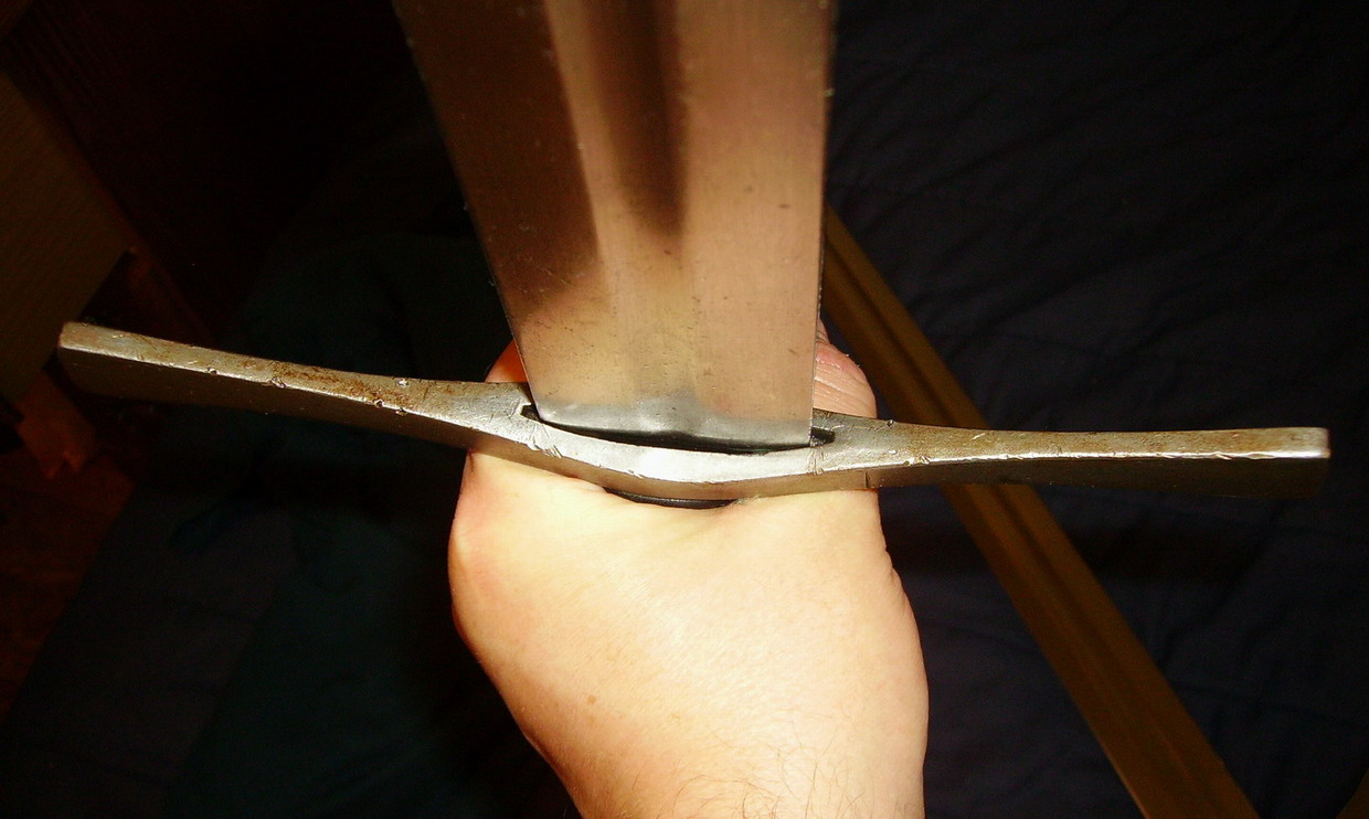

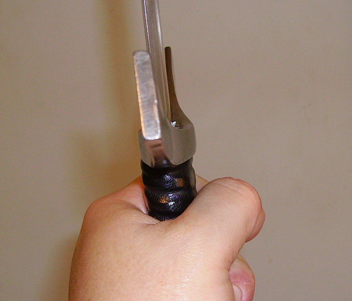

The second sword is that ‘more pristine’ example I mentioned earlier. And, although this one looks prettier, with edges that are completely intact, she is a pig. This one is heavier, thicker, and clumsier. Had I purchased this one first, I’d have been pretty disappointed, to tell you the truth. Everything on this sword is thicker: the guard, the pommel, even the blade, which shows almost no distal taper at all. She is roughly four ounces heavier than sword #1 and the point of balance is only about a quarter inch further down the blade, but you feel those extras. For a minute there, I was thinking that this was actually one of the Windlass versions; but no, the guard is marked “Made in Italy”, and the blade has that tell-tale Del Tin sheen (more of a gray than a shiny silvery appearance, as you’d find on most Windlass swords). The guard has an overly-long slot in which the blade shoulders sit; this just looks kind of sloppy. The other sword does not have this long a slot. The guard also has a more extreme curve than on the first sword, plus, it is off-set and does not line up symmetrically with the grip, which is another sign of sloppiness. The pommel shows a pretty glaring casting flaw; I tried to get a picture of this but it did not turn out well. It may be up near where the tang is peened, but it’s definitely a flaw and not caused by hammering the tang.

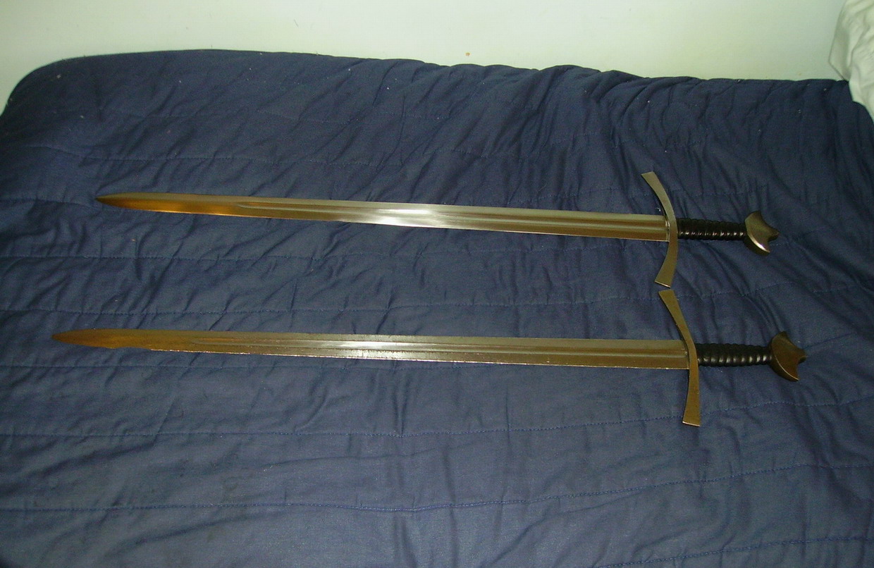

COMPARATIVE STATS:
Weight: Sword #1: 2 lbs, 15 oz; Sword #2: 3 lbs, 3 oz.
PoB: Sword #1: 5.75 inch; Sword #2: 6 inch
All other measurements are identical:
Overall length: 39.5 inch
Blade length: 32.75 inch
Grip length: 4.75 inch
CoP: 24 inch (approx)
So, why are these two swords so different, even though they are both the same model and made by the same person? Well, of course, there’s the fact that all DT swords are made entirely by hand, so the fact that two otherwise identical swords may be slightly different should be a given. However, I’m not entirely sure that’s the case here; the differences are so many and so obvious that I think there’s a little more at play here. Do I have a theory? Glad you asked. I do have a theory (and let us be honest, it’s a pretty wild guess, and not based on any other facts in evidence): I think sword #1, the nice-handling beater, is an older sword, made when Del Tin was MRL’s go-to guy for swords, and was made with more care and attention to detail. Sword #2, on the other hand, is much later in production, and may have been made at the tail end of DT’s relationship with MRL. It shows that, at this point, Del Tin had one care to give, and that care was now gone, so he kind of phoned this one in. Sure, it’s a wild guess, but it’s probably as good as anything, at least until someone comes forth with some inside info.

off-set guard on sword #2 [ Download ]
Sword #2 guard [ Download ]
Sword #1 guard [ Download ]
