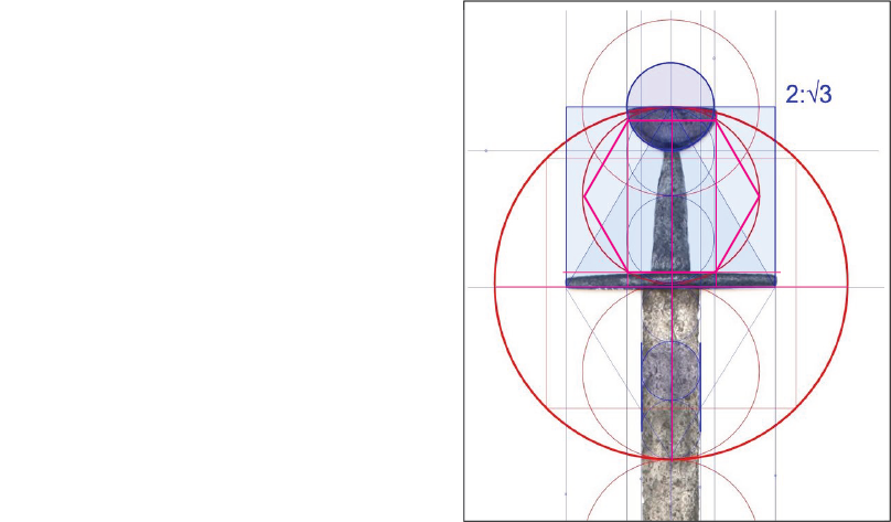

Peter Johnsson
Posted: Wed 23 Nov, 2016 10:27 am Post subject: |
See below the use of an inscribed hexagon to define the guard height and the pommel diameter.
Attachment: 142.38 KB
Mark Lewis
Posted: Wed 23 Nov, 2016 1:05 pm Post subject: |
Thanks Peter, the hexagon does seem to fit perfectly!
Looking forward to hearing your additional comments...
Peter Johnsson
Posted: Thu 24 Nov, 2016 2:21 am Post subject: |
Mark Lewis wrote: | Thanks Peter, the hexagon does seem to fit perfectly!
Looking forward to hearing your additional comments... |
It is indeed tempting, but remember: we cannot really know until we have reliable data on dimensions and a good reproduction of the outline of the sword. I have seen very nice preliminary geometries crash and burn spectacularly when I later had the opportunity to document and analyse the original sword.
-Small details and flaws in the image matters!
This is only very preliminary results that suggest a possible solution.
