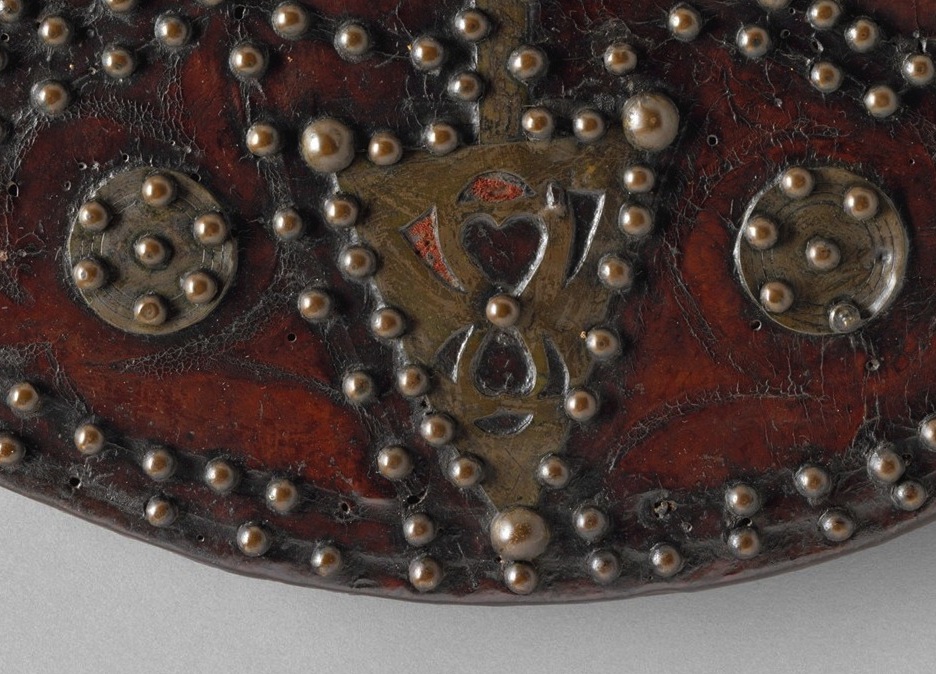

I left this query relatively broad to be of general interest to the readers. However, my particular focus is on the Scottish Highland targe in the Metropolitan Museum in New York.
The description says nothing about silver plating, but the visual evidence is clear:

Now that I look at the buckler I believe that this is not plated as you think. My guess is that the rivets and decorative plates, which now have a yellowish shine and are made of brass, as the MET says, once were tinned with a high percentage of silver. You make all the brass applications, drill the holes, create the necessary depressions, mount everything for a try, when it fits you tin all the pieces and rivet them onto the shield. That 's how I would do it. Are you certain that the white you can see on the pictures is silver?

After doing a bit of reading, yes, acid treatment of alloys was used by the Romans. Coin blanks with low silver content were treated in an acid bath, which removed the copper, etc. from the surface. When struck in the coin dies, the rough silver surface became a nice uniform silver colour. With wear, though, the alloy beneath showed through.
With your brass piece, the acid removed the zinc from the surface layer.
I had not considered tin or a silver-tin alloy. I think this would have to have been via a "hot dip" process. In my limited experience, this produces a thicker layer than that seen on the Met shield. But my experience is with tableware, which may purposely have a very thick coating.

Brass caps on steel rivets for armour are connected via tinning. You punch a depression into a piece of brass, roughly cut around it, add a mixture of tin and a flux to the inside of the brass cap, place the rivet into the brass cap, the flux + tin in-between and heat it up. The tin gets liquid, cools down again and the cap holds onto the rivet. The layer produced is not very thick. As for hot dipping, I know from riding equipment which was tinned that the tin on the mouth pieces wore off at some point. I believe that the coat was not very thick as a thick tin layer is quite hard to remove. At least with a tongue and a bit of spit...

Most targe nails, 1623-1745, were cast, but some are clearly domes of thin brass sheet. They are easily damaged.
