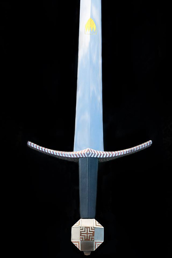

Also, what do you guys know anything about the longsword below? The Pinterest poster said that it was dated from 1300-1350, located in Reichsstadtmuseum, Rothenburg, Germany. Is it a longsword of German make? Is that an accurate assessment of the period it was in use? The brass inlays on it are gorgeous!

Jon Makar
Posted: Thu 29 Sep, 2016 4:15 am Post subject: |
Thanks Nathan, you're grrrrreat! *Tony Tiger*
Though I am sad about all of your photos being ripped and posted on Pinterest. I will duly note that about the Rothenburg collection. It's too bad that there are so many people who couldn't just enjoy history at its face value and beauty; that so many had to change what they saw to what they wanted everyone else to see.
Ok, so, last one I promise!!! Anybody know anything about this longsword? It looks northern without a doubt...And, following popular trend, it's probably also Mr. Robinson's photo.
