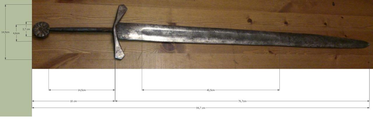

Hello All! I am very curious about Your opinions on this most probably medieval sword (photos attached).

It's a fake. I don't know of any extant genuine medieval swords that have a fuller that begins part way down the blade like this one. That's not to say that there are none, but it is exceedingly rare so the fuller automatically makes the sword highly suspicious. The proportions of the sword, especially the grip in comparison with the rest of the blade, are wrong; the sword has a massively big long sword grip, and yet the blade is clearly a single-handed sword. Further, the blade seems like it's a poorly made Type X style blade, but these were never used on long swords (and Type X blades would be extremely out of date by the 14th century in all parts of Europe). Lastly, design work on the pommel, while not unheard of, is comparatively rare on genuine antiques and makes the sword suspicious; modern people are far more likely to want to decorate a pommel in this way than medieval people.
Taken as a whole, I cannot possibly imagine that this sword is an authentic sword from either Eastern or Western Europe.

Do you know of a good reason that it's "probably Medieval"?
The two most unusual things to me at first glance are:
1. It's a very long grip for a blade that short.
2. I've never seen a round Medieval European tang before. Round tangs are unusual on swords - one runs into a problem with the tang turning in the grip core.

I am strongly inclined towards skepticism regarding the sword's age. I've never seen an original with a cylindrical tang like that. That's not a big deal in itself; I haven't seen a lot of things. Still, in practical terms, I can't help but think that it wouldn't take long before the wooden portion of the hilt started turning around that tang, not unlike a roll of paper towels. The termination of the fuller so far from the cross also strikes me as very odd. It's not easy to tell from the picture, but the blade seems unnaturally beefy to me, and as someone already pointed out, it's an awfully short blade for that long of a hilt. The pommel also looks like it's been machined. I definitely don't see the signs of advanced age (patina on the pommel, for instance) that I would expect on an old sword, and it appears that there are bits of wood (I'm assuming that's wood) protruding from between the pommel and tang, as though the pommel had to be shimmed to keep it in place.
I could be dead wrong, so please don't take my word for anything, but I think that's someone's shop class project that got left out in the rain for a few days. At best, a Victorian decorative reproduction.

I'd have to echo everything they said. The design would be exceedingly strange for the proposed date, the proportions are off in every way possible, the craftsmanship is crude and inconsistent, the patina doesn't look its alleged age, and if the tang isn't welded on I'll be very surprised.

That tang is a classic 'rat tail' tang, cylindrical with almost no taper, that could not possibly hold up in combat. Nothing says 'modern' like a 'rat tail' tang.

Everything about this sword points to fake. The fuller termination, the rat tail tang, the pommel, blade length to grip length ratio.... In my opinion this is a rather ugly sword and clearly not original. Is someone trying to pass this off as legitimate...?

I'll just comment to say it couldn't be more wrong if it was wearing a t-shirt saying 'I was made very recently, buyer beware.'

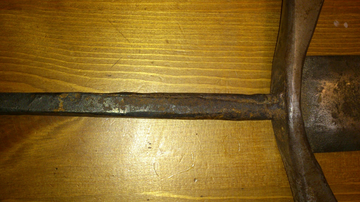

more pictures on the matter pointed

What does not make sense to me is why someone would bother to grind a new fuller during cleaning. It would be strange enough to deepen an already existing fuller because you're damaging a historical artifact, but creating one where it doesn't belong, i.e. beginning part way down the blade, seems inexplicable.
On what basis are you certain that the blade is medieval?

It could be a composite creation and some part of it might be "original" as in older than late 19th Century... but whichever part that might be - the pommel? part of the broken tang? - it certainly is not the crossguard, at least. It's just way too chunky, in exactly that Fischer-Price sort of way that a lot of overbuilt modern SLOs exhibit. And it also seems to be welded to the tang, which is something I've never seen or heard of in a Medieval sword. The sword also shows a very rough finish all over beneath the light and very uneven patina, indicative of either rough filing or power tools and either way, IMO, too sloppy to be pre-industrial work - metal was expensive back then and labour relatively cheap, see, they didn't waste the material on sub-par half-finished work like this.
I could be wrong! But that's my honest opinion, no slight intended. I just hope you haven't spent money on this.

With regards to the fuller, there is a medieval sword at the Cleveland Museum of Art that has a fuller that starts just after the cross guard. It has been published extensively, to include Records of the Medieval Sword. It is a type XIIIb, page 112, catalog #XIIIb.3. This is a very unusual feature, an opinion voiced by Oakeshott himself.
However, this is not an endorsement for the sword's authenticity, it is not a 14th century sword. I agree completely with Chad and the other forum members. I trust the opinions of the members of this community, even more than my own. I think their judgement is sound in this case.

It's hard to see for certain, but in the first photo it looks as though there is a central ridge that extends from the new fuller to the point. If there really is such a ridge, it's another indication that this sword was made relatively recently. Central ridges do not belong on Type X blades; there might be one or two genuine antique medieval swords that have them, I do not know for certain, but a central ridge is basically unheard of for swords of this type. Modern makers, particularly those not making swords in the last couple of decades, often start with a blade that has a central ridge and then modify the blade so that it has a fuller, and make it look roughly lenticular in shape, instead of making a truly lenticular blade.

I find it strange that the pommel's engraving is so misaligned from the tang. Not just that, but the flatness of the pommel's plane which meets the grip is also extremely skewed. The pommel appears itself to be very asymmetric, which is curious given the obvious pains taken to engrave its design. One would think the craftsman would take more care in centering the weight of the pommel rather than carving that design onto it. This doesn't look skewed because of excavation or mishandling since the tang sits flush with the pommel.
I agree that this is likley a "fake." Not necessarily contemporary, because the pitting looks quite deep, but perhaps Victorian?
Other suspicious things in the photographs include the extremely flat and polished crossguard (in contrast with the rest of the piece), and simply the overall beefiness of the thing. Of course we don't have it in hand and it could actually feel like a proper sword. Those are just the things I tend to see in terms of its construction.

I'd just like to add my weight behind the fact that sword is not original.
I've handled, oh, a good few hundred medieval swords now, from the 10th to the 16th centuries, from all over Europe, and I've studied more in publications and academic papers than I can even begin to list.. That's not a medieval sword.
the fuller position on the blade is a great big flashing neon warning sign of its origins. I see no indication of a difference in patina between fuller and blade flats to indicate that this was recently added, even if such a process were likely to be done. That any restorer would grind in fullers to an unfullered blade, frankly, strikes me as nonsense on par with the notorious Blankenshield conspiracy theory on the Armour Archives that all armour had rolled edges, and the curators were snipping them off...
While the photography is, if you'll excuse my bluntness, crap, I'm not seeing any indication there of significant age. the patina there is no different to carbon steel blades I have in my workshop from the 1930's to 50's. It does not have the sort of depth of patina I'd expect of an original - even around the tang hole where the sort of cack-handed restorer who might grind a fuller in would struggle to reach into the corners..
the entire pommel - the technique of decoration, and the artistic style of decoration used on it, even the tone of the metal itself looks to be a modern zinc brass. the round drilled slot, likewise. Again, there is nothing of the sort of patina I'd expect of an original.
the tang cross-section is nothing more than a wallhangar with no resemblance to originals. If by some freak of chance the blade is antique, then there is no way in hell that the tang is original too - and by association, we must conclude the hilt furniture attached to it is equally suspect.
the details of the cross are ropey as hell, I'm seeing the sort of striations I'd expect off a slack belt sander without a platen, running something like a 80-120 grit belt. It is in no way medieval.
blade, cross, tang, pommel. None of those components are medieval or display the characteristic details I'd expect from even a rudimentary replica. I am exceptionally sceptical that any of the historians at Wawel would consider this to be an original, in any shape or form, unless their field of research was absolutely unrelated to medieval arms.
Quite simply, this item is as bent as a €6 note.
At my most charitable, I'd say you have a lovely example of a mid-20th century, low-quality replica, probably from between the end of WW2 and 1980.
I understand you may wish to lash out angrily at those like Mark and Tim who were rather blunt - especially if you paid anything more than a tenner for this thing. However, their comments were absolutely spot on. Even a cursory review of photographs shows nothing even remotely indicative of a medieval sword of any date, yet alone one of 14th century origin.
