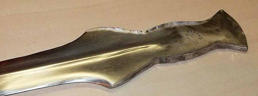

I used to wonder about flanges on iron hilts, too, but they're a piece of cake. Here's what I did on my own Naue II hilt, with only one brief experiment for practice, inadequate tools, and no training:

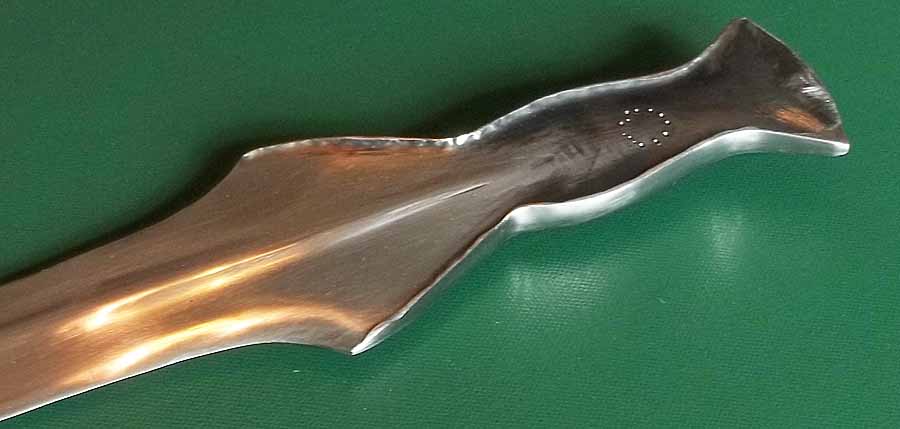

I think that took 15 or 20 minutes. A little filing and sanding gave me this:
This is scrap mild steel, 1/4" thick to begin with but I had presumably thinned the hilt area somewhat already. I just left it a little extra wide when I cut it out to allow for the flanges. And I'm sure a trained smith could do it much better and faster than I could! My flanges are not as wide as some originals.
Trying to weld the flanges on will be a HUGE amount of fuss and work, by comparison. Grab a hammer and go for it!
Matthew
